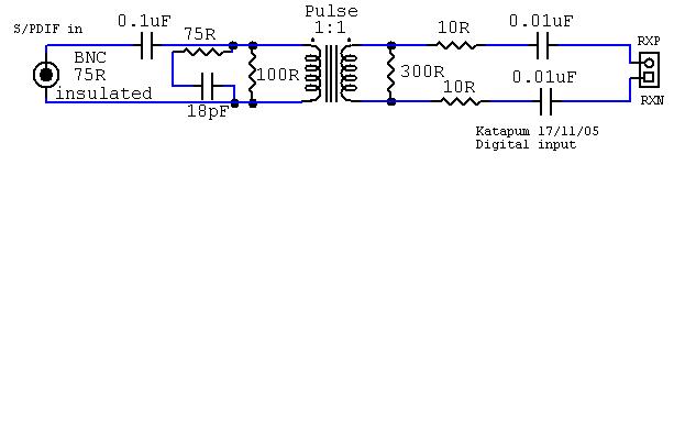

I was looking at just the Pi pad. Wich adapts the 100R to the 75R of the connector?
75R at the output // 137R +26,1R + 26,1R = 100,667R at the trafo, Seems right?
But seen from the other direction
100R at the trafo +26,1R + 26,1R // 137 = 72,1R at the output.
Wich seems a little low?

Katapum's RX input not right
I was just looking at Katapum's posting on the RX input and the impedance looking from the bnc connector is not 75 ohms. You will get better impedance match if you get rid of the 100ohm on the primary side, replace the 75ohm with 150ohm, and replace the 300ohm on the secondary with 150ohm. The zobel cap is around 22pf if the transformer leakage is ~0.5uH.
Experts, please comment if the calculations are right.
Thanks,
rlim
Thanks,
rlim
Re: Katapum's RX input not right
this looks quite similar tom what we did a while ago
http://www.tentlabs.com/Products/DIYDAC/DIYDAC.html
I'd suggest a screen in the transformer to increase common mode rejection
best
rlim said:I was just looking at Katapum's posting on the RX input and the impedance looking from the bnc connector is not 75 ohms. You will get better impedance match if you get rid of the 100ohm on the primary side, replace the 75ohm with 150ohm, and replace the 300ohm on the secondary with 150ohm. The zobel cap is around 22pf if the transformer leakage is ~0.5uH.
Thanks,
rlim
best
Re: 1:4 transformer
actually it is 1:1+1, yes in terms of impedance that is 1:4
Yeah I know, but we learned in 10 yers. By then I liked the minicircuiits, now we have better ones like Scientificonversion and Schott.
best
rlim said:Guido,
Looks like a 1:4 transformer is used. Jocko is gonna smackah your face.......
best
