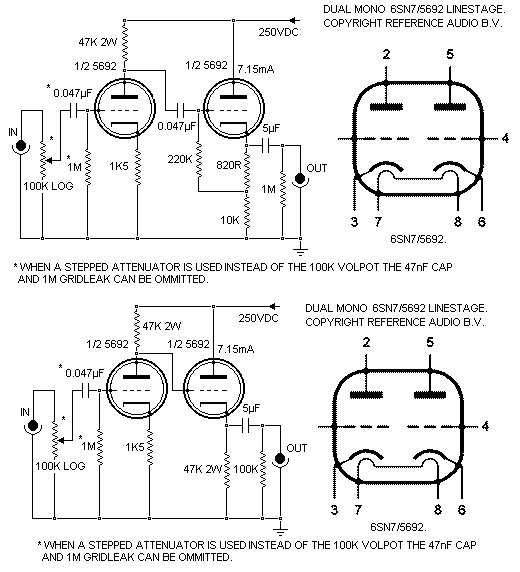

If this amp is not an "acceptable" design, any other suggestions using 6SN7 tubes? I need more than unity gain though as I 'd like to use this amp for headphones as well as a preamp.
Glenn
Check thru the past threads and you will find a 5692 line stage that Frank posted. I built it and its very nice.
Thank you!
That looks simple also.
I'll look at the Aikido, but my goal was to build something with the parts on hand (6SN7's, 330V PT, etc.).
Joel was kind enough to send me this suggestion also.
Glenn

"Joel was kind enough to send me this suggestion also..."
Although I didn't design that PSU. But I do think the direct coupled circuit would be an improvement. It's also simpler.
My gripe about both circuits - and any other RC coupled design used to drive a low impedance like headphones - is that they rely on the load to generate the NFB which improves the linearity. With 100 ohm phones, you essentially have a 6SN7 (or two) with a 100 ohm load. What do you think that's going to sound like?
The fact that a circuit like this sounds almost identical to the headphone amp on the player itself says a lot about the equally poor quality of the solid state version, and even more about the lack of power needed for most 'phones.
There really is only one way to drive a low impedance (probably reactive) load with vacuum tubes, and do it linearly, and that's with a transformer.
Save the cathode follower for buffering a high source resistance.
Joel
