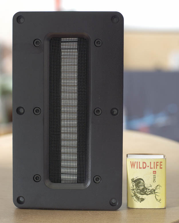

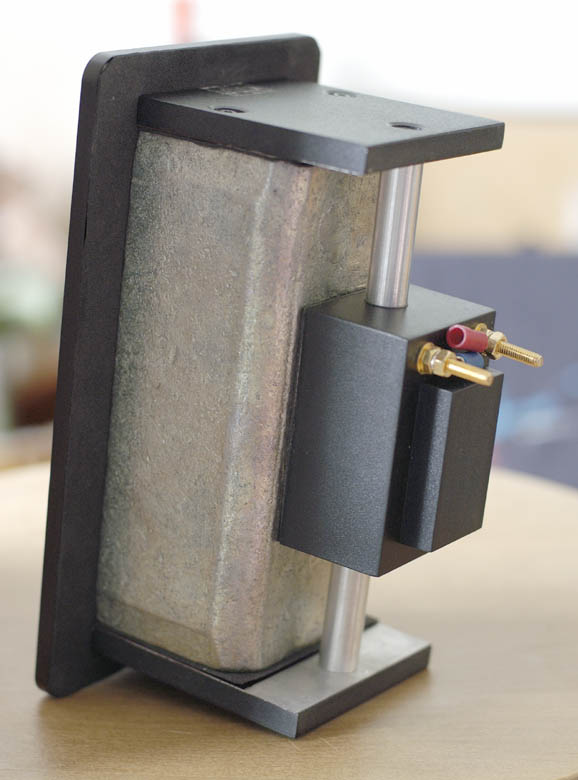

Yes, despite them often being marketed as "ribbons" the plastic film with thin conductors and no transformer is a different beast entirely. Many years ago, Wharfedale osld a headphone using this principle as referred to it as "isodynamic" because the drive was applied over (nearly) all the surface. I think that was the right name for a technology that is essentially a flexible PCB held in front of some magnets. By contrast, a true ribbon has a corrugated aluminium foil suspended between the pole pieces of a powerful magnet. The difference is that the true ribbon has a lower moving mass and operates in a constant magnetic field, whereas the isodynamic drver has a necessarily higher mass and operates rather nonlinearly because the field is applied from the back only. It's a bit like single-sided electrostatics vs proper push-pull...
Go for the true ribbon, You won't regret it. (I bought a pair of ESG1 to go with my JX92s but haven't got around to making the boxes yet.)
Okay, will do the G2Si then, unless some of you can come up with a good reason why now.EC8010 said:Go for the true ribbon, You won't regret it. (I bought a pair of ESG1 to go with my JX92s but haven't got around to making the boxes yet.)

EC8010 said:Yes, despite them often being marketed as "ribbons" the plastic film with thin conductors and no transformer is a different beast entirely. Many years ago, Wharfedale osld a headphone using this principle as referred to it as "isodynamic" because the drive was applied over (nearly) all the surface. I think that was the right name for a technology that is essentially a flexible PCB held in front of some magnets. By contrast, a true ribbon has a corrugated aluminium foil suspended between the pole pieces of a powerful magnet. The difference is that the true ribbon has a lower moving mass and operates in a constant magnetic field, whereas the isodynamic drver has a necessarily higher mass and operates rather nonlinearly because the field is applied from the back only. It's a bit like single-sided electrostatics vs proper push-pull...
Ii just wanted to clarify about the NeoCD series. They're built like the true aluminum ribbon, however instead of corrogating the ribbon they simply sandwitch it with film to give it strengths. It acts very much like a pure ribbon, however it has much more mass than the pure aluminum ones. It would almost be a hybrid between Planar and ribbon technology... I have a blown JP2.0 I think I'll have "repaired" with the NeoCD element to compare the sound.
