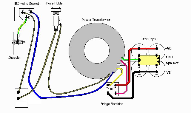

this is my first amp build, and i am using the monoblock kits from antique electronic supply.... instead of following the kit exactly, i am mounting it on an aluminum chassis... im using a front mounted power switch, chassis mounted binding posts, and a detachable power cord...
my first question is how do i hook up the power switch and still use the fuse that is supplied... the kit comes with a switch mounted on the power cord, which i am not using
this is what i have so far
is this correct???

EC8010 said:
Fuse first, then it protects you from a fault in the switch. Even better, use an IEC socket with built-in fuse.
No ...Double pole switch first then fuse.....safety directive....
Why ? if power cord is reversed a double pole switch will avoid the possibility of shock from a damaged fuse or holder from current flowing round other part of live circuit. I now fit double pole switches with a neon inside.
Also. My mains supply is split phase 2x 115V so in practice both power pins are actually live but an electric shock will only be 115V.
I see the logic, but an IEC lead isn't reversible. Is the plug into the wall outlet reversible? We Brits have non-reversible wall outlets, and we like a fuse in our IEC inlet so that we are protected against any fault, including the switch (there was a thread on here recently discussing a switch that gave a member a shock).

jdbrocious said:
im lost......
i will be using an IEC outlet, but it will NOT have a fuse in it.....im using the inline fuse from the kit.....
there will be 3 wires coming off the IEC into the chassis (pos, neg, ground i assume) .... the power will lead down to the power switch which has 2 wires.... where should i put the fuse???
and the ground should just goto the chassis correct??
I alway's wire my amps with an IEC inlet module (no fuse, I use a separate fuse holder like you).
Black wire (hot), should have the letter "L" on the back of the IEC inlet, goes to fuseholder first, then power switch.
Other side of power switch goes back to power transformer.
White wire (neutral) goes directly to the power transformer.
Green/Yellow wire (ground) goes directly to the chassis right next to the IEC inlet, keep this wire short.
Others may have other methods, but I find this is very common on a lot of shematics I've built (US based).

one question..... my switch ony has 2 connections......should i just double them up??
You have a single-pole switch. N (neutral) wire goes from IEC connector to transformer. L (line or "hot") wire goes to fuse, then switch, then transformer. If it's a chassis mount fuseholder, wire from IEC connector goes to BACK terminal, SIDE terminal goes to switch.
Diagram shows switch wired first, which is NOT the preferred connection. G (ground) terminal should be grounded to chassis with its own screw - don't share with other ground connections.
If you have a friend who's an electrician, electrical tech or engineer, ask him/her to look it over before you plug it in.
Tom is correct, like I said in my text only post, the fuse should be the FIRST thing the hot lead goes to.
I didn't catch that in the picture, sorry.
