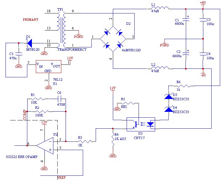

As some of you know, I am trying to build an offline half-bridge SMPS for audio use.
My prototype is almost working, but I have an issue with regulation. I started another thread, but as the problem is now different I have decided to keep them separately for ease of search.
The turns ratio gives a peak secondary voltage around 70V, while I want a regulated output of around 60V.
If I leave the supply unregulated, going to max. duty cycle, the output is too high. If I regulate it "manually" adjusting duty-cycle, (but open loop), the voltage is good for relatively heavy loads, but goes to more than 70V with no load or light load, and load regulation is not too god.
The obvious solution is close the loop, of course.
BUT: as I have it now, it oscillates: at light load, there is a 5Hz, 2Vpp oscillation (not sine, but more like triangular) around the correct set value. As load increases, its freq. increases to, say, 30Hz at 150W.
At some load, it even oscillates badly from almost 0V to 50-60V, I suppose that duty cycle falls to 0 and the controller stops.
I have tried to compensate with no results so far.
I attach the schematics of my current feedback setup. By the moment it is using only the internal SG3525 opamp. I know that the optocoupler diode excitement is very simple and will have some temperature drift, but that's not very important for me by the moment.
Can anyone tell me what's wrong??? Thanks!

I've said many times that this arrangement is not going to work, and I've also explained how to get it right. :dead:
Your output filter requires a zero at 280hz for compensation, but it has to be implemented before the optocoupler, and also two voltage rails can't be sensed in that way.
Sorry, Eva. I only wanted to put it to work reasonably well without adding more complication, but if that's not possible...
What's the reason for the requirement that the zero is implemented before the optocoupler? You'll agree with me in that it adds complexity and if that can be done in the control side... much better. But I am sure you have a very good reason.
About sensing both rails, well, it is sensing both of them, but it is true that it has no GND reference, so if the load is not somewhat symmetric it can produce different voltages in each rail.:)
Thanks for your help
Rather than being useless as you could think at first, the output ripple voltage waveform is very important for the control circuit, but it must be precisely attenuated and averaged by the pole/zero/pole response of the error amplifier before it goes through the optocoupler, because optocouplers suffer from limited and asymmetric slew rates, delays and storage times, thus distorting high amplitude high frequency signals badly.
Also, placing the error amplifier and the compensation after the optocoupler will allow the optocoupler to saturate and cutoff during transients without the error amplifier being able to track the average value of the output voltage waveform and compensate for it in average.
Concerning output voltage sensing, note that the frequency response of the output filter of each rail changes as load is increased. If you take feedback in such a way and apply a different load to each rail you are likely to get instability because you are summing two different transfer functions that may probably interact producing notches.
Also, even when compensation and output sensing are right, you are going to need a minium dummy load to ensure stability.

They use a fb. scheme very similar to mine, with no additional opamps. Eva, what do you think of this arrangement? Perhaps it can't work properly?
The only compensation is a pole at the output of the error amplifier. I really don't know how it works. It is wired as a comparator instead of an amplifier with moderate gain.

EDIT: I've managed to reach the schematic, but, does it work? is it stable? :D Who knows? Note that they are using the optocoupler in a very different way.
Well, in fact they are using the optocoupler in a very similar way to what I do. (although they put the output voltage directly to the error amp used as a comparator).
I have been reading the SG3524 datasheet (very similar to SG3525) and they recommend compensation by means of a capacitor+resistor from COMP to GND.
I still don't understand why compensation should be done before the optocoupler. Please could you explain me that, Eva.

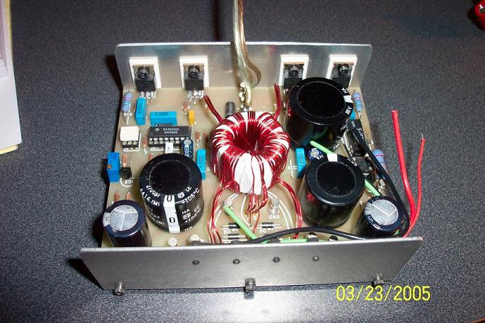

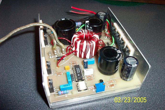

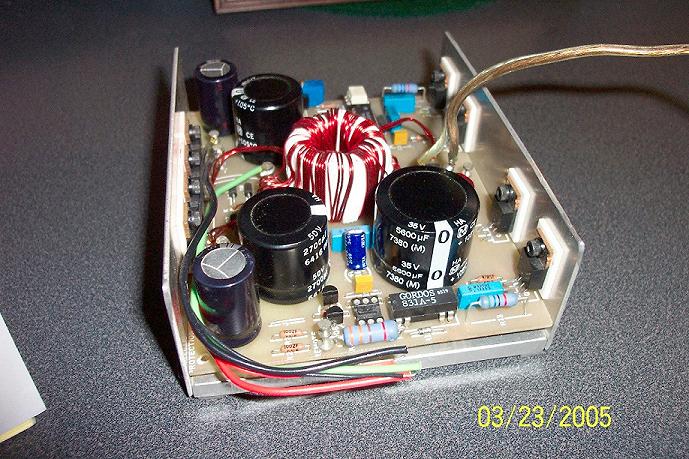

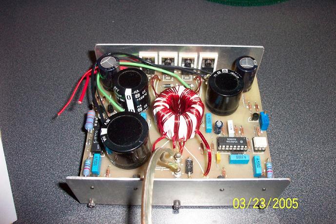

Here is a pic of the DC-DC converter I built. More to follow......
STEVE :cool:

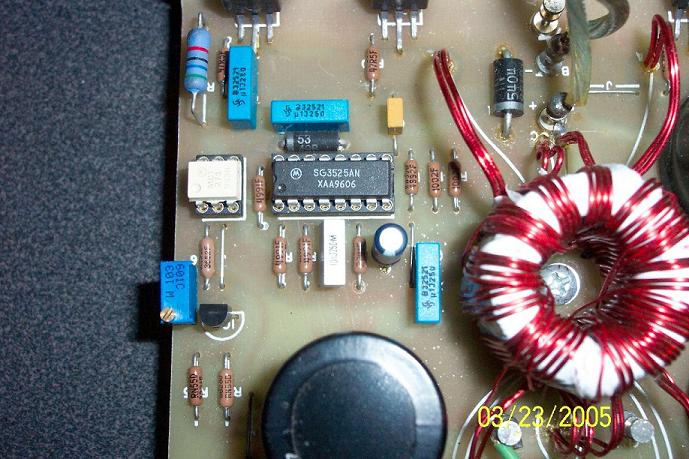

...last one!
These are old parts. Note the Motorola symbol on the '3525. In fact, all the semi's are Motorolas, the PWM IC (SG3525AN), the N-Channel MOSFETs (IRF540), the output rectifiers (MBR10010), the Optoisolator (MCT-271), and the 19V 1W zener diode (1N5???), the TL431, and the reverse-polarity protection diode (1N5406).
On subsequent versions, I will substitute the MCT-271 with the CNY17-2, which has a CTR ranging from 63-125%, or the 4N35, which is steady at 100%.
Also, note the pot I put on the very edge of the board- this allows me to tweak the output voltages +/- a few volts.
Also, the biasing resistor has been lowered from 36.5k to 33.2k, yielding voltages for the amp's output section at +/-33V, and voltages for the amp's input stages at +/-42V. This tiered output arrangement is necessary for the amplifier's output MOSFETs, which require a voltage higher than the Vdd and lower than the
-Vss to operate over their entire linear region.
