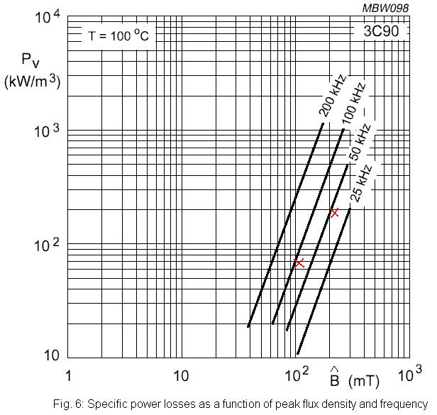

After the weekend, I have only been able to test the supply as it is now (at 40KHz with the Coilcraft transformer), with real amplifiers and under real music load.
My transformer has 26 primary turns, yielding around 1100 Gauss peak flux density at 80KHz, but about 2200 at 40KHz, that is too high.
The only component that has been heating up a bit after some pushing is the transformer itself. Can it be due to excessive flux?
Following the 3C90 graphs, the thing is that running at 50KHz/2000 Gauss produces about 3 times greater power losses than running at 100KHz/1000 gauss, so I assume that running at 80KHz with 1100 gauss should reduce transformer heating very noticeably, am I rignt?
In every other aspect, it works excellent! No noise in the amplifiers and almost no interference in a test FM radio.

I'm not aware of such core heating issues. In my 120A power supply the E42 cores of N27 (low frequency) marerial are routinely driven to a bit more than 300 mT (3000 gauss) at 32Khz, and they get just slightly warm, not enough to be discomfortable to the touch. Under transient conditions the flux may even reach 450mT, but I've seen no more traces of core saturation since I got the current sensing and control stuff right and I found the way to achieve a symmetrical layout.
Note that high frequency ringing causes a lot of dissipation in ferrite cores, particularly in low-cost low-frequency materials such as N27, but I got rid of almost all the ringing.
My core is 3C90 grade, not a very high frequency one of course.
Are you suggesting that leakage inductance causing ringing can be the culprit?
When I speak about heat, I mean that it reachs around 25ºC above ambient (DS1820 sensor placed between lateral ferrite and the windings) after half an hour or so, with 2x150W peak music load. Not very worrying but I would like to extract far more power from it.
This is the graph I referred to. Marked are the two referred points of operation: 40KHz/2200G and 80KHz/1100G.
Losses from the material are about 3 times lower at the higher frequency (1.2W versus 3.5W aprox with ETD44).
As the transformer is the same, _its_ temperature should go noticeably lower, am I right? (ok, mosfets will be hotter unless I fix the low rise time problem).

My calculations are wrong, divide the previously mentioned flux densities by two. I was not taking into account that I'm using two primaries connected in series. This makes me consider going for a lower switching frequency (30Khz), and three turn secondaries for a bit more than 200mT instead of four turns for a bit more than 150mT.
Core losses seem to increase with the flux density squared and also seem to increase proportionally to the inverse of the frequency. You may try to find a compromise between 40Khz and 80Khz, lets say 56Khz. That would reduce core losses without doubling the switching losses.
Anyway, note that your 3C90 ferrite suffers the lowest losses at 100ºC and is good up to 200ºC, so 50ºC or 60ºC operation shouldn't be a problem. On the other hand, switching devices are not so happy at 100ºC.
