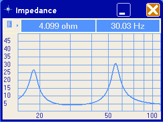

I would suggest you measure the output voltage of the amp at the onset of chuffing, then you could get an estimate of velocity and SPL by plugging in this number into your program.
Measuring within a foot or so of the outlet will allow you to neglect room effects for the most part and more easily compare the results. You could even record the sound for each case, notch out the fundamental and have a more objective measure of chuffing.
RonE....Thanks for that suggestion. I had considered this approach, but wasn't sure if picking the impedance from the WinISD graph and applying ohms law was valid.
I've attached the impedence graph, showing 4.099ohms @ 30hz, the test frequency.
Using a multimeter would give me the RMS voltage.
Can I simply use P=(E^2)/R to calculate the power?
The reason I conducted the testing in-room was to combine the outputs of the front mounted port with the side mounted drivers.
If I can use your method, life would be much easier. At least for the single frequency part of the tests.
As for detecting the "chuffing", it is quite easy to be consistent. As you approach the "chuff zone", the nature of the sound changes noticably when you increase the level by 1dB
