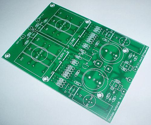

With several people from Audiostereo forum we decided to build ALEPH P 1.7 clone.
I will use ERO 10uF caps for input and output. There is also place for BG N type 10uF and 47uF capacitors on the PCB. WM8816 chip will be responsible for volume control. I tried to locate power transistor in one line. Connected to one heatsink they will work in the same conditions.
Suggestions seen miles - this will be my first PASS LABS construction working in A class.
Mr. Pass thanks for sharing this project 😉

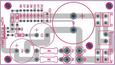

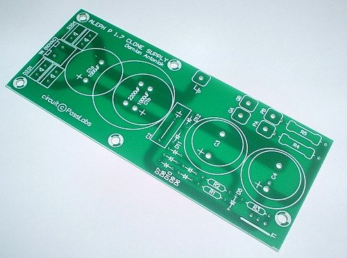

This is how PS board look. I don’t like GND track so there are few things to correct 😉
There are no pictures yet. This is just a project. I will order several of this boards so they should be ready in a couple of weeks. I can’t wait the results and sound of assembled preamplifier.
veteran said:
Hi Digi01. Your pcb is really nice too 🙂
I tried to reach compromise between power and ground tracks. As You can see they are connected in single point. But small MKT cap close to transistor may be useful 😉

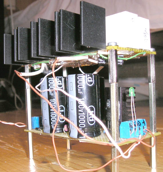

2 floor version 🙂
Me like it ...
Ofcourse much much ugglier - but my experimental p2p AlephL is built in 2 floors 🙂 (in the picture there whole Al - only pot, trannie and connectors missing to make him functional ...)
