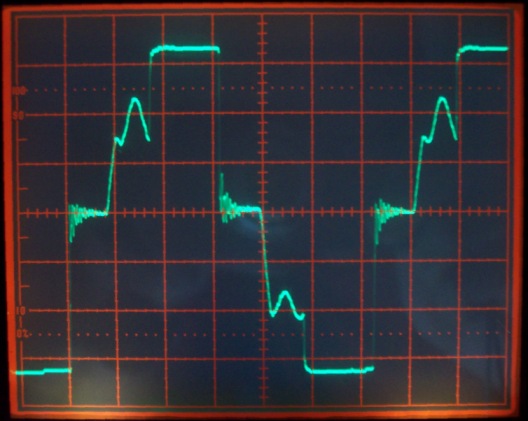

Unfortunately, my mosfets have exploded again, as soon as I have increased output power from aroun 100W to about 170W. Now I had 2sk2141, 6A/500V, more than enough for that power.
I attach a figure of the switching waveform when it worked (100W output, worked fine and everything cool), with around 20% duty cycle. It is something strange, isn't it? Y scale is 50V/div, X scale is 2us/div
What can be the cause of the violent explosion (they weren't hot, in fact they exploded just when I plugged the supply)? I am quite puzzled.

This has been a very interesting discussion so far! (Sorry, Pierre, for all the smoke...)
I would perhaps suspect the MOSFET drive circuitry and check that out once again. The IR2110 type driver parts are very picky to set up correctly. I've tried to use them before and ended up going with a transformer drive which is much easier to deal with (to me, at least). If the IR part is not bypassed REALLY well and everything with nice tight loops, you may be getting ringing above or below the Vgs limit of the FETs(usually around +/-30V). The layout problems (if there are any) and ringing will increase when you start to increase the load.
If your FET's blew at turn on, maybe you had FET cross-conduction because of the driver chip not establishing a stable operating point yet. If I recall correctly, though, the chip has UVLO, so would not have turned on without an adequate voltage. Strange indeed...
Something to think about...
I'm curious about the ringing in your picture, too, and hope someone (Eva ;) ) can shed some light on that.
Matt.
The waveform looks right. It shows discontinuous mode operation. Output inductors are charged during the on time, then they discharge during the part in wich voltage rests at center (inductors are effectively shorting the secondaries), and then the transformer is left free so it tends to reset from the previous cycle but the discharged inductors in the secondary side clamp the voltage.
As carvinguy said, this may be an issue with gate drive and resonance peaks exceeding maximum Vgs rating, thus punctuting metal oxide gate isolation and inmediately destroying the device (and the gate driver IC).
It may be also an issue with continuous conduction mode and secondary side diode reverse recovery, since according to the 100W waveform 170W semms like a bit past the continuous mode boundary. Note that if there is a gate drive issue, it may arise only in these circumstances.
You will need to connect oscilloscope probe directly at MOSFET terminals and build an improvised common-mode filter for the probe like the ones shown in the picture in order to get an accurate picture of gate drive waveforms.
