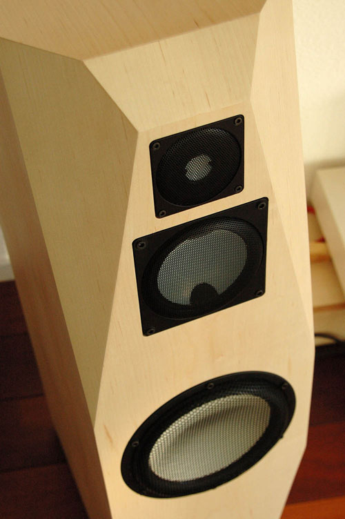

As I'm impressed by the Avalon Opus Ceramique speakers, I took the challenge to make look-a-like speakers. It is not my intention to replicate the Avalon speakers, I respect the intellectual property of the original designers.

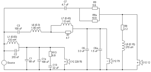

The status of the speakers is that they have been built (with great help of Gydotron and Luc), and are playing music. I'm currently iterating on the crossover filter design (which is a huge challenge :h_ache: ).
I've created some documentation which describes their status so-far (for my own reference), which I think might be useful for others as well, so I've posted it on my homepage:
Milestones pdf files
Looking forward to your feedback, suggestions and ideas! :idea:

Some pictures of the current result:

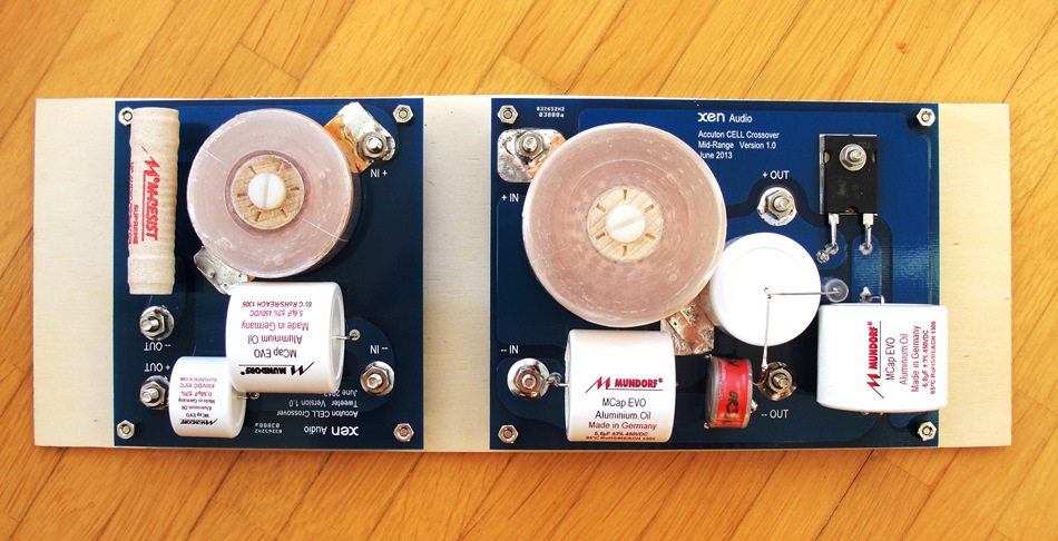

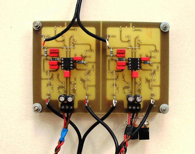

Here a couple of pictures of a quick-and-dirty test setup for the crossover.
The passive crossover is as recommended by Joachim.
The active uses a prototype board we have for general active crossovers for 2 channels of 2x Sallen Keys.
Opamps (OPA2604) are used as followers for now, but we have an adapter board (DIP8) for 2x 2SK2145 wired as JFET followers.
All worked first time.
Patrick
