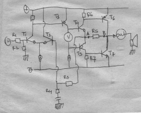

Then I draw this (attachment). At a glance, it seems nothing special, it is ordinary CFP output stage. But I think it works quite differently, it has EC loop around T4,T5,T6,T7,R5,R6,R7.
The main audio loop takes feedback from point A, it is not directly to the speaker node, but bridged by R5. I think about 10ohm for R5 and 100ohm for R6+R7.
The whole audio loop will determine the condition on point A, not the speaker node (point B).
If there is any voltage imbalance in R5, it will makes T6/T7 gives current until voltage A=B again.
For example : A is more positive from B. The current will be flowing from A to B. This means, the same current will be flowing in R6, since T4 is common base transistor for this case. The rising voltage in R6 (10x voltage rise in R5, 100ohm/10ohm), will be activating T6 to give current to point B until A=B=balanced condition.
The "CFP like" output stage is actually having local EC loop, without affecting the main loop
Another interesting properties is the feedback take point is separated by R5 value to the speaker, in this example is by 10ohm resistor. I hope any nonlinearity caused by loudspeaker back EMF (it it existed) will be taken care by the local EC loop on the output stage, not entering the differential, because the feedback node is from point A.
I have 2 questions.
-Is my thinking above works AT ALL?
-If it works, what is the output impedance of the whole system? Is it 10ohm output impedance (since the feedback take point is 10ohm away from the speaker)?

I think so. and R5 degrades performance since (non-linear) base currents of T6 and T7 multiplied by R5 are substracted from output voltage as an error voltage that feedback has no chance to correct.
Hi, EVA,
Aha, I see the difference in our point of view. I remember somewhere you said that the whole feedback amp is an EC itself, why bother making the so called "EC"? You're right here, the feedback system is an "EC" itself. 😀
This is exactly what I wanted. The feedback of the main loop is taken from point A, and if the speaker is giving any non-balance in A-B (R5), it will be corrected by the "CFP" local loop, not entering the differential (main global loop), because if it is entering the global loop, it will be transformed to higher order distortions.
If I wanted that the main loop fix it, I would take the feedback point from B, and R5 will have to dissappear.
I have tought that not everybody will agree with the basic concept itself.😀
Anyway,EVA, do you know what is the output impedance of the idea? I don't know how to calculate output impedance from a schematic.
It's hard to estimate output impedances, but you can put upper and/or lower limits to them very quickly.
For your circuit, output impedance won't be smaller than R5 divided by the instantaneous current gain of Q6 or Q7 depending on wich one is conducting.
Note that this current gain changes with frequency and with collector current, so it's a potential source of distortion (that neither the main loop nor the CFP loop can't attenuate).
I think that you are overlooking the effects of base currents and transistor non-linearities, while error correction is based just in the opposite practice.

Two member said that I'm drawing CFP, maybe that is what I do😀 Reinventing the wheel one more time.
Funny thing, is, that I got the final shape of CFP is from step-by-step thinking, resulting the same CFP. I'm not thinking at all at first to draw CFP. That's just what it looks like in the end.
At the process, I also think about "current drive" effect of R5 operation, I tought waw, I draw something here.

It is a real honour if you give me your opinion about what I draw in post #1. What is it?
I think about the feedback point of the global feedback is taken in point A, and speaker node is point B, they are apart by R5 (I'm thinking about 10ohm for R5). EVA pointed that it has 2 loops like I tought.
Do I make EC or just making CFP? From your criterion, it does have 100% voltage feedback (but it is doing so not like ordinary "CFP" which is emitor of the driver and collector of the driven is tied together without R5, but with current drive of R5, T6 and T7 will always naturally try make voltage A=B), does this makes the idea is just a CFP?
The global feedback is only controlling voltage at point A, it doesn't care about point B.
T6 and T7 works by giving or sucking current so point B will have the same voltage as point A. T6 and T7 doesn't care about the global feedback (what voltage in A should be), it only "views" the condition of point A and B , by giving or sucking current until A=B.
