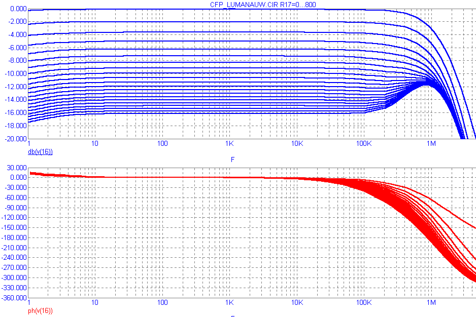

Post #42 :
In what value of R5 the curve starting to show no "peaking"? And what is the "peaking" means?
I assume the blue one with peaking is the effect of R5 value, and the red one is the distortion figure.
What is the units in horizontal line. Is it frequency? The blue curve show acceptable below 100k. Is this below 100khz? But the red one starts non linear (between curves) at 10k, I think.

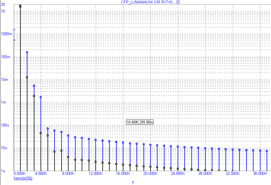

Post #43
I look at the distortion below 10khz. Below 10khz, the even orders are bigger than odd order. Above 8k, the blue one is everywhere. This one scares me The blue one dominated by higher frequency ones. If my interpretation is right, this won't result in nice sounding amp, too many higher order harmonics.
Do you have the same type of curve from your NP-PMA?

David,
blue curves are amplitude characteristics for R17 as a parameter. R17 = 0, 40, 80 Ohms ... etc. It is my CFP output stage according to http://www.diyaudio.com/forums/showthread.php?postid=700155#post700155 simulated, with R18 disconnected. Just an influence of R17.
Red curves are phase characteristics.
X axis is frequency. 100k = 100kHz.
lumanauw said:Hi, PMA,
Post #43
Take into account that this is for the open-loop CFP output stage. And pretty high input voltage, 18V. For the values under 10V the distortion is very low. The distortion also depends on quiescent current and transistors used. The only aim was to show you that R17 (R5) increases the distortion, and that it is not good to use it.
Yes, I have measurements of my error correction amp, not only simulation.
Also, you can see measurements of the CFP class A output stage here:
http://web.telecom.cz/macura/pma1_measure_en.html
