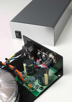

Hi. I'm looking for the schematic or any technical information on the optionnal Michell HR supply for their DC motor turntable. it is supposed to be a great upgrade to the original small DC wall adapter. This HR supply is quite expensive. It contains what is called "Never-Connected" supply. After a search on the net I collected these informations:
1-The HR supply uses "Active-Rectification" followed by a solid state regulator, possibly a standard LM317. It has a variable DC 9V output, so the DC motor speed can be adjusted. It has High current capacity, specs unknown, possibly higher than the standard wall adpater 9V dc supply. It is suing also a toroidal transformer. See image.
2-The HR supply image gives a few clues about is circuitry. We see rectication diode, possibly Hi-Speed recifiers, and possibly two low ESR caps. The "Active rectification" is probably use after the first diode rectification. It is using possibly the MAX797 IC's and a FET as active rectification part. The LM317 or LT variant (low drop-out) rectifier and the FET are probably mounted on the supply's back.

what you suggested is certainly interesting. i'm not sure if i have the technical ability to provide inputs though...
the lm317t is used in this supply. you can see if clearly if you zoomed in the pdf of the hifi news march 2004 review. the to220 device beside the lm317t looks like an IRF transistor.
there's also another to220 device on the board. possibly an adjustable regulator capable of regulating from 24v to 5v.

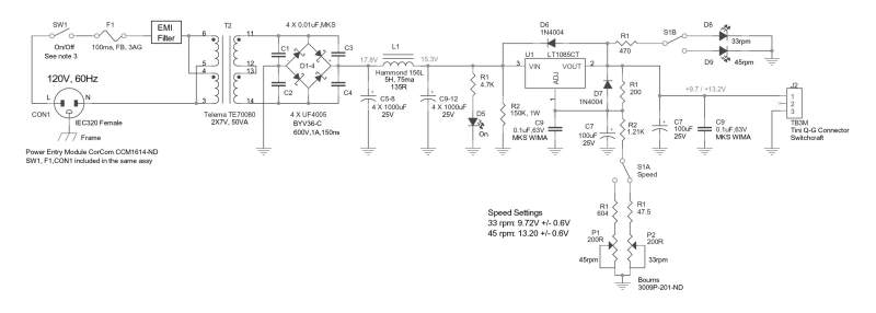

I was able to get some more info on the HR supply. Here a first draft of possibly how it is working. I don't pretend that is working but it is a start to discuss the principle.
From the article, it is mentionned that a comparator drive a capacitor charging FET according to some phase angle duration of the 60Hz AC voltage.
This schematic shows this principle.
Any comments on this circuit and or additons
Thanks....

would be interesting to see what components you will be using for your schematic.
i'm not sure if the max951/952 chips can be used, but if they can, it will simplify the circuit to one supply(more inline with the NC circuit?) instead of needing a +/- supply and also remove the need for a reference voltage source.
cheers
garbage

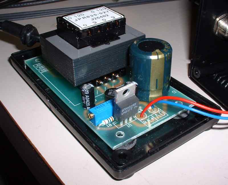

I got my table today, and the first thing I did was to open the standard power supply. It is a pretty standard LM317 9V voltage regulated supply, see image. The only thing special about it is the small DIN connector to connect the table's motor.
The supply voltages are: Transfo out 12Vac, 14.8Vdc no load, 9.7Vdc output voltage.
From the image that I got of the HR supply, it is a Never-Connected supply section supplying exactly the same LM317 regulated circuit as the original one. Not very sophisticated indeed. There is certainly place for improvement.
I'll try the suggestion of the OPA548.

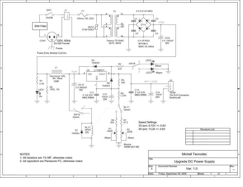

Here my first version of the upgrade supply:
-EMI filter at the AC input
-50VA low leakage transfo
-Schottky rectifiers with snubber
-C-L-C Filter with Panasonic FC Caps
-Low Drop-out Regulator
-Dual speeds selector and speed fine adjustment multi-turn pots.
It was difficult to find the 3 pins connector mini DIN that Michell uses on its power supply. I found it!
It is made by Switchcraft. It is a Tini Q-G Connector, 3 pins, model TB3M, panel Mount.
