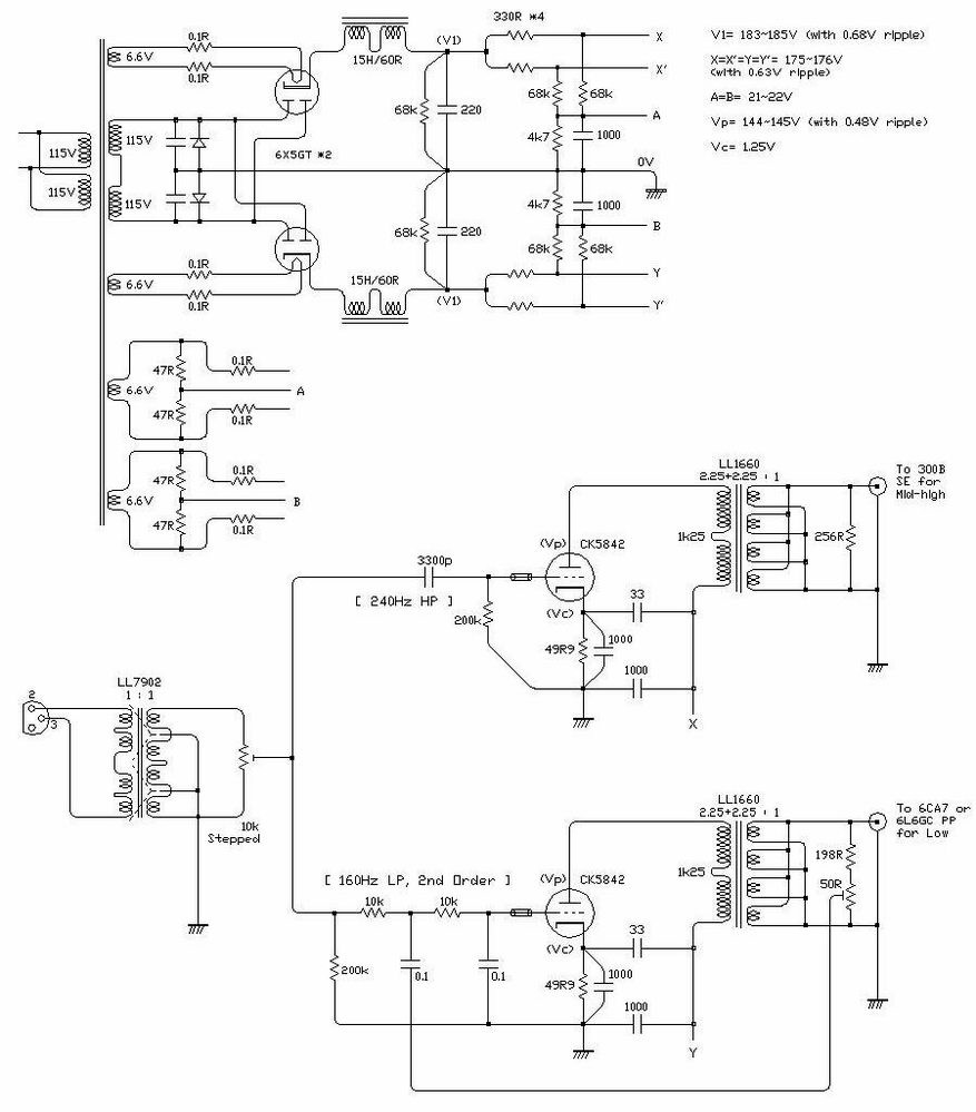

So here it is:
1) LL7902 wired as 2:1 step down input transformer with a 10k load (stepped volume control). I'd like to make a relatively easy load to the upstream equipment. I've tried "DAC chip-direct" with this transformer and got a very good sound. I'll probably do it again. Now the transformers are much further from the chip, so a step down would make it an easier load.
2) The wiping arms of the stepped VR are connected to 2 loads: 1 for passive 1st order HPF & the other to a 2nd order active LPF, both gain stages are mostly original "Euridice".
3) Output transformers are LL1660 (18mA), wired as 4.5:1 (or, 5k:250R approx. )
4) Powered by 2* 6X5GT with 2* 1N4007 as one & a half bridge, fed into 2* 15H/220uF LC, then splitted into 4* 2k/1000uF RC for each tube.

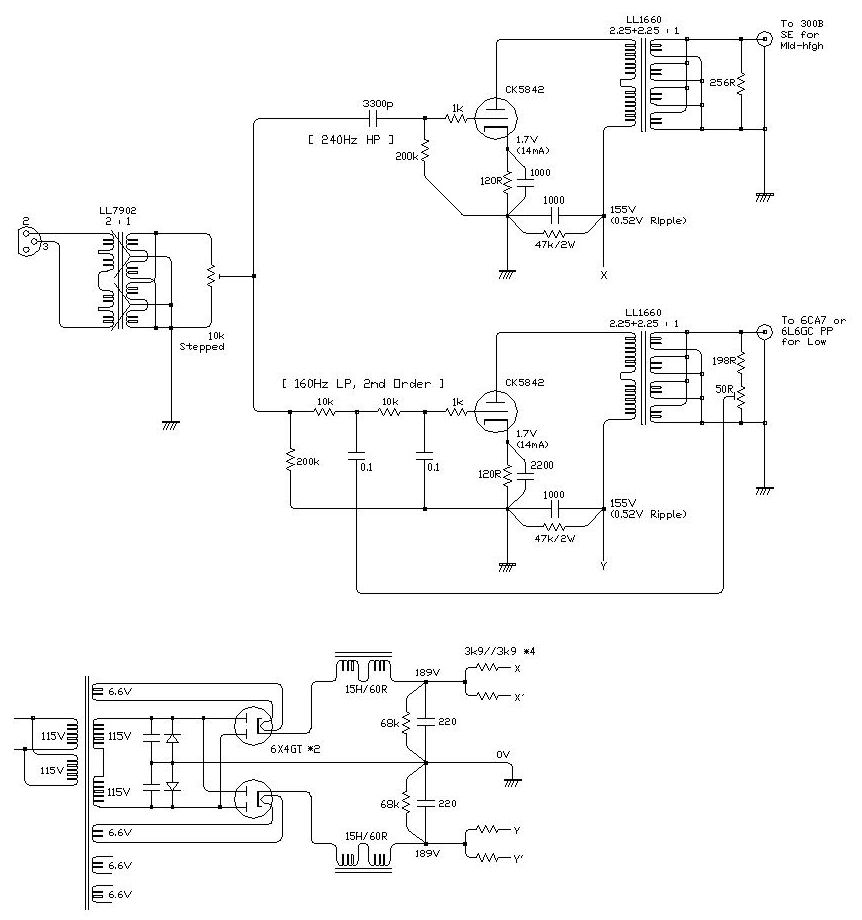

Concerns & possible tunings:
1) Hum! It's still there, although barely audible on the listening position, it'd of course be better totally gone. I got approx. 0.5V ripple on the B+, but there's no space for more LC or RC. And the heaters are AC powered.
a) Does Ultra-path work on such circuit? If the hum is partially caused by magnetic coupling, does Ultra-path help?
b) Is DC heater necessary or any help?
2) I got 155V B+ after LCRC, 5V shied of the original 160V. With the same 120R cathode resistor, I got only -1.7V bias, which is only 14mA. In the Raytheon specs, it recommand 150V B+ with 60R cathode resistor to get -1.5V bias & 25mA, so I'll probably try this. This tube seems prefer high current to high voltage. So I'll try maintaining the B+ with more current.
3) LL1660 output transformer has 100H in the primary winding. With pretty low plate resistance of CK5842, ideally I can get very very low frenquency out of it. To let them sing all the way down, I use huge cathode bypass caps here - 1000uF in mid-high channels & 2200uF in lows. I'm not sure, before realizing the lowest 1.3Hz or 0.6Hz, there might be other evils coming up. Or, once I try smaller cathode resistor, this "issue" would be mostly gone?
4) 2:1 step down on the input seemed unecessary. And it made the total gain too small, I'll probably rewire them into simply 1:1 isolation. Working around those tiny pins is really painful though...
5) I got several 6C45 lying around, maybe worth a try in this circuit. I've had a simple test on microphonia by tappin on the glass. The CK5842 has a relatively firm & short "tung", and the 6C45 in my 300B power amp has a crisp & very long "ding-ring-ring-ring- ing -ing -ing -ing -ing ....... ". ( Except for tubes themselves, maybe it's also because the 6C45 is working under plate choke / direct coupling with most of its natural amplification, and the 5842 is working with a largely stepped down output trans. I'll do more experiments on these tubes.... )

There's a massive terrible hum in the first test. Tens of mV of hum! Then I made a virtual CT of the heater winding by 2* 47R & connected the center to ground. That cured the hum mostly but not entirely. ( I'm confused, aren't those heaters insulated from cathodes? Why can't I just let them float? )
Heater and cathode form a parasitic rectifier diode which injects rectified AC into the cathode. You can avoid problems from this by reverse-biasing this diode to more than the peak voltage of the heater, so try returning your virtual center-tap to around +20V instead of ground, but make sure there is low impedance to ground.
Sayonara
in euridice type of preamp,I prefere CCS for heaters,also elevated to at least 50 volts potential via divider;that divider must burn at least 2 mA to achieve good results and must be decoupled via minimum 10 micro.
try also to use smallest cap you can for cathode decoupling or ,even better, use NiCd instead of cathode resistor.

For those insterested in the schematics, please see the attachment below. This is the current version, will surely be changed in the near future.
In the LPF portion, I took 2 sets of RC in the same value & use the feedback to tune the filter Q. This is derived from the books and was working good on my previous OP-based xover. However in this circuit, tuning the VR got little effect. I'm confused on this portion, will try more in the future.
Again, any thoughts or suggetions are appreciated.

How careless I was!
Reviewing the schematics & data sheets, I found the primary winding of the output transformer ate 17.5V !! So the plate saw only 133V, no wonder the lowish current. :dead:
At this point, the tubes are barely awakened. I'm going to rebias them tonight.

Last night I managed to have the following mods done:
1. Elevating the heater supplies by approx. 20V
2. Reducing the cathode resistor to 49R9
3. Reducing the RC filter's R from 2K to 330R
4. Adding Ultra-path caps
5. Replacing the grid stopper resistors to ferrite beads
6. Rewiring the input transformer to 1:1
7. Adding 2* 0.1R in each heater supply circuits.
2&3 above brought the operation point to 140~V on the anode, -1.25V bias & 25mA. The load line is slightly higher than the "original" 160V/20mA, & in the point of somewhat lower V & higher I. On the curves, it looked good.
It was 1am when I finished them, so no energy left to do a listening test.
With larger current draw, I found the ripples on power rails also enlarged a little. By DMM, I saw the output hum/noise was still 1.1~1.2mV as before. I know, this is bad 🙁
I don't fully understand how the Ultra-path works. According to TubeCAD Journal, the cap value is proportional to the amplication realized in the circuit & the cathode cap size. By this, I chose 33u as a trial, assuming I got 30 some of gain.
What would happen if this cap is over-sized? Over-compensation?

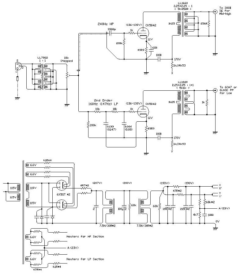

I reconfigured the chokes added more filter onto the power supply. Now it's:
Parelleled 6X5GT fed into a 2u motor start cap, then 15H ->100u*2 -> 15H -> 180u*2 -> splitted 2* 120R/200u RC -> splitted 4* 1k/1000u RC
Funny enough, now the ripples on the series 2 LC are larger than the independ LC before, which are 0.79V & 0.76V. Then the following 2 stages of RC show 0.73 & 0.6V of ripples. (The final voltage on the tubes is lowered by several volts, though, thus slightly shifting down the operation point...)
Which means, the power is not any cleaner then before 🙁
However, the outputs are indeed a little bit cleaner, 1.1mV on the DMM. And much cleaner on the listening test. Now the slight hum from the speakers is almost all from the power stage. Turning the VR of power amp shows no change (enlargement) to the hum.
I now suspect the DMM is not trustable.....
And it does sound cleaner, smoother, more fluid-like, & the dynamics is well maintained, which is of course better (to me at least).
The last 3~4 steps on the VR still show some buzz on the output, I've not rewired the input transformer yet... I'm not worry about it though, those positions are almost never used.
BTW, the WE (ultrapath) connections are now cancelled. Although it's not likely, maybe something was wrong in my previous installation.

Finally, I found a major fault on the previous installment- a ground loop :dead:
This is a 2in-4out unit, so inevitability the "signal ground" splits at the input.
And I built it in one chassis & all 4 channels share the same power source, so the "power ground" splits here.
So, in between, a big circle🙁
I rearranged the ground routing several times, finally found a good single point to ground to avoid most of the noise -- near the "power ground" point. The signal ground is broken on the LPF section, so the loop is also broken.
Meantime, I also tried reconnecting the chokes into a common mode operation, making HT & return sides in series. I've read an article which highly recommends this connection, so I gave it a try.
The input transformer was re-configured, too. Revewing the datasheet, I finally realise that the ultra high level is not needed here. So I rewired all the coils in parallel to get a very low DCR thus low copper loss. Doing this way, I lost the CT, so I just float the GND wire of the balance input.
Now this pre amp sounds even better 😀 The buzz is almost completely gone. Turning the volume controls of the downstream power amps from min to max shows NO change on the noise of the speaker output. (I stuffed my head into the horn when testing).
The most noticeable improvement on sound quality is the high. May I say it's so delicacy & airy😀 At quiet night, listening in low level is a real treat. Effortless details are floating in the air and filling the room. I think the input transformer is the key.
However, thing's never perfect. Although most of the time the output is clean & quiet, at the last few steps of the volume control, some buzz grows & finally becomes offensive at max.
I guess connecting the GND of balance input to the secondary's ground might resolve this full output buzz, but have not tried it yet. However, this somewhat "wastes" the isolation it provides.
On the circuit diagram of the magnificent Marantz T-1, I see the balance input ground is connected to the common ground via a little choke (or just a ferrule?). I guess this might filter out some high frequency rubbish in the ground route, just like the trick on connecting "digital ground" & "analog ground" on the DAC PC board?
Attached is the latest circuit diagram, in case some of you are interested.
