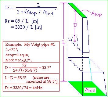

Well after a really long week and a weekend full of work tonight after I was able to do a little research on the Voigt Pipes. I found a good website with the equations, couldn't find them on that site.
I was trying to see how big I would have to make it for the tuning frequency I want it. It seems to me that is doesn't really matter how deep the box is, the only think that matters is the length of the front baffle. For my tuning frequency I would have to make mine over 12 feet tall. The ceiling in my room is only 10 feet.
I might see if I can get like some 1/4" wood and build a voight pipe to about 42hz or so, but it looks like right now I don't have the time.

These are supposed to be a quarter-wave device, right? If your enclosure needs to be 12 feet tall, that sounds like your tuning frequency is around 20 hz. You can have a 6 foot length for 40ish hz, or fold it in half for a 3 to 4 foot tall enclosure.
I'm starting to think that a sealed enclosure with the Pioneer drivers would sound good- but a terminated tapered tube might sound better. I'll start running some numbers to see what it would take.
Yea I think I'm gonna try for a tapered pipe I'm just not quite sure where to start designing, but I'm gonna try to design one. These will be for a school project that I am doing. I'm going to compare the TL probably TQWT, a vented, and a sealed box. I'm going to try and run some frequency responce tests to schow the differences. I'd like to put a lot of time and effort into the TLs to make sure they are well designed and I'm gonna design a couple different boxes.
I cannot decided on a tuning frequency because of so much room gain. The only way to come up with a somewhat smooth responce is to tune at 22hz, which is really low with the fs on this speaker. What would you all recomend?
