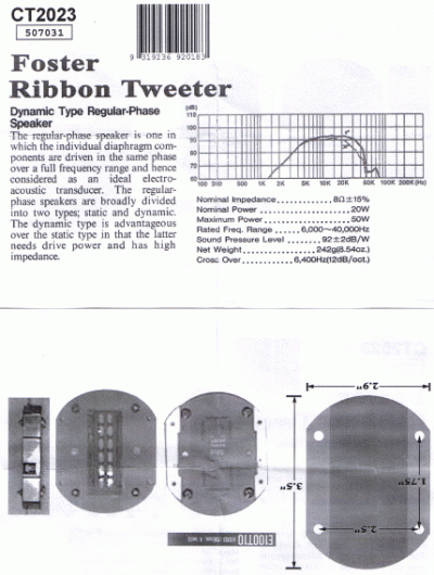

Cross overs a tad high at 6,400 Hz. I'd like a good drive that goes from around 700c/s up to 7 or 8 k. Any ideas in Aust' George?

Thanks george. Looks like the real deal. The others were Fostex not Foster and they were marketed as "regular phase tweeters " I think. I've got the data some where.
I think it might not be a "true" ribbon. The yellow color is a strong sign that there is a Kapton plastic membrane. True ribbons (almost?) always have aluminum ribbon elements. A true ribbon that small would also need a matching transformer. I don't see anything that seems to have space for a transformer. My bet is that it's a magnetic planar with a Kapton membrane and multiple aluminum foil conductors attached.

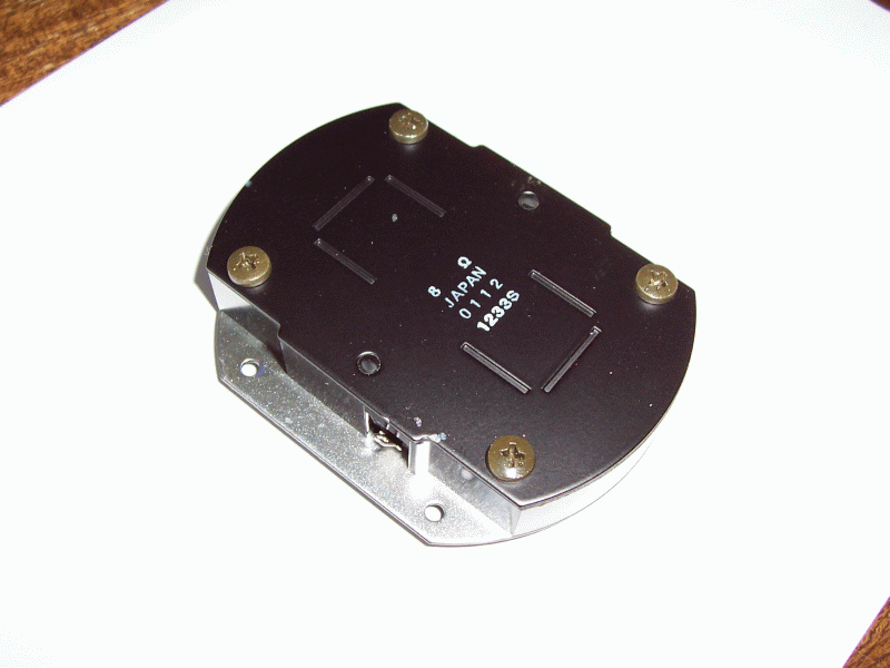

They've come in a couple of days ago and out of the 10000 they recived the manager said they have 1700 left, so I bought 2 just for the hell of it, this is a picture of the back that now you guys can see. they are quite heavy i put them on the kitchen scales and ther just under half a pound each.

you tried them yet george?
ive fired one up today, makeshift arangment ina small off oem bookself speaker , in place of the dome need to work more on xover and such, but first imrpessions are good, very detailed, bordering on harsh, but i cant be sure as the sensitivity is too high atm and needas an lpad. ill report back.
the off axis response in the vertical plane is shocking, but i think that could be normal for ribbons of this shape?? correct me if im wrong im new to ribbons

Nuh, just put them on the geny and listened, very clean, I'm into esl's i only bought them because they were so cheap, one day I'll do something with them.
They remind me so much of the old no longer available Infinity Emmit planer ribbon, they extend out very clean with the geny, and are very sensitive. For that price you could do a very cheap 4 or 8 times line source, that way they'd be idling at big volume and the vertical dispersion will be heaps better.
