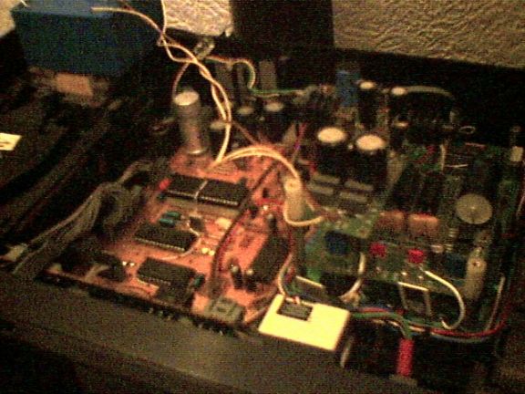

Does anyone know what Mission did (if anything to the cd650) to make this player?
CD650:- http://www.diyaudio.com/forums/show...18853&perpage=10&highlight=cd650&pagenumber=3
Mission:- see attached pic
(they both have a rear toaster)
Kind regards,
Ashley.

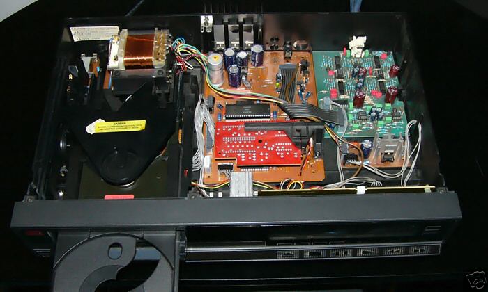

Think it is obvious from the pictures.
The mission has a new output stage. seems they did not mount the standard output circuits on the main pcb (the 650 has two outputs, one on the main and one 'additionally filtered' on the separate pcb on the right.
As for the other changes:
the pcb above the main pcb in the mission contains the decoder microprocessor and some additional logic. This is a bugfix which can also be found in the 650 (mine had one, replaced it with the single microprocessor because the old broke).
the small pcb in the front on the right in the mission is most probably the powersupply for the display. It is integrated on the filter pcb in the 650. Ive done the same in my 650: removed the filter pcb and put a small pcb in for the display powersupply.
The 650 in the picture is modified btw, the caps on the mainboard are like the mission.
Interesting, what chips are on the mission pcb?

Thanks for the information.
The chips on the board are:-
4 X hef4051bp
4 X ne5532 signetics
1 X hef4094
hef4094 : 8-stage shift-and-store bus register?
hef4051: 8-channel analogue multiplexer/demultiplexer
Ne5532 (op amp)
I assume most of the chips relate to the display features since some connectors run to the display board, and volume functions (which I cannot access because i'm using a Marantz remote). The player does not work with the extra pcb disconnected.
The player uses the motorola controller rather than a SAA7210. What does the 'bugfix' pcb do ?
In the Mission the Saa7220/A, and TDA1541 were originally inside but i took the TDA1541 out and put in a tda1541A S1 since they had already provided sockets.

The cmos chips will be there for the volumecontrol and maybe even deemphasis switching (i guess).
The smallest pcb is the display powersupply (ac) and +32V for the display driver/keyboard decoder chip. Which communicates with the other controllers (two more iirc).
Yeah, mine also has no 7210 but a M4... something. Never got more info on it. No datasheet
But it seems to be pincompatible.
I'm (ab)using my 650 as testmachine. Busy with a dac (2 times 1541, D1 output stage) which also has it's own clock (Tent). See the pic. But currently working on the preamp, pcb on it's way..
Dont really get the fascination for the 650, it's plastic all over... When the dac is finished
it's going into a CD80 🙂
Edit: can only guess why they had to add some hardware last minute. Just know the newer versions of the 650 dont have it, there is a single processor used. Got one of them because i killed the processor in my machine and it is pincompatible with the pcb.
