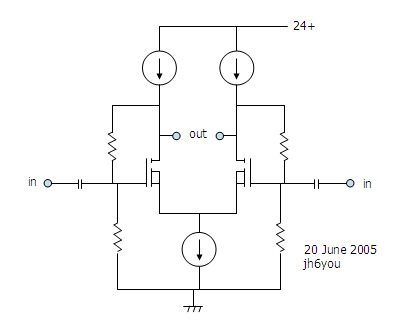

Here is my concept darwing.
I will not draw any details . . . I am afraid of Nelson Pass . . .
My target is 5W@8ohms and 10W@4ohms.
A-class of efficiency about 5%.
Of course, the current source amplifier.
Nelson Pass, is the concept feasible?
Will it drive normal 2-way 90dB speakers too?
Or, should I change the x-over network?
Or, should I go with the efficient single unit speakers?
Regards
jH

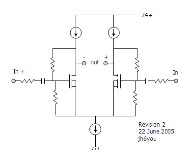

Hi jH !
The schematic you have shown looks like an X-SOZ, without any series resistor at the input. It will have a very low input resistance, because of the feedback from drain to source.
If you add a series resistor at the input, the amp will turn into a voltage amplifier.
Thorsten

Thorsten, thanks for the hint about the input R.
acaudio, mine is almost the same as yours. Did you build it?
Actually, mine was inspired by Zen V6 and Zen V7 . . .
I will go out to find IRF240 and collect them and others . . .
Regards
jH

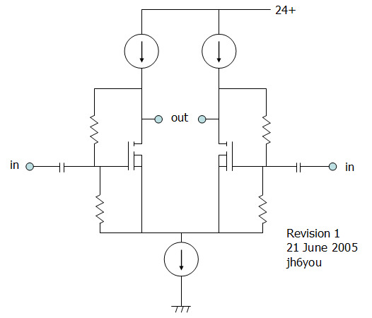

Here is revision 1.
Regards
jH

Mr. Pass,
The specifications in the F1 owners manual states that the input impedance in balanced mode is 100K and unbalanced is 50K. However, the FirstWatt product page for the F1 gives the input impedance (no qualification) as 80K. Which number is correct?
The output swing is also given as +-20V but the amp has a single voltage PS and the outputs are biased to sit at +13.8V. Should the spec read 20V P-P perhaps?
GL
