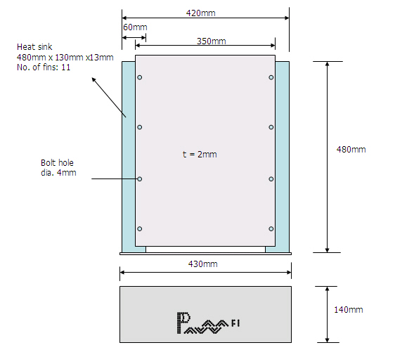

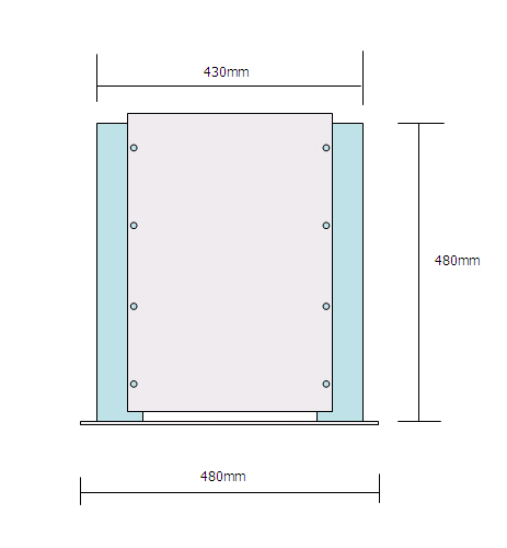

Yes. It's wide. At first, I was thinking about 430mm, which is the same as the body width, but changed mind to 480mm to have 25mm wings to the left and right.
The final dimensions might be slightly modified. It would depend on the heat sink dimensions that I will order tomorrow.

Just what I thought! That geometry wouldn't please my eyes Seems like the chassis would be 480x480! Not a nice sight to me, sorry JHKind of big front JH, 480mm!!!

Thanks a lot, JH. I will take that as a complimentLadies and gentlemen! . . . Steenoe is my wife . . .
Still, an even sided square s*cks, somehow

The heat sink shop did not wait for me with the size i wished . . .
I re-ordered the size of 480x130x6 having 11 fins . . .
The size was by eye measure . . . not by calculation . . .
Feel somewhat smaller . . . Anyhow . . .
The attached drawing is the final dimension of the chassis . . .
Hope this time steenoe will say ok . . .
Then, I will sign the divoce paper . . .

Indeed, he does That chassis looks very pleasing I just hope you can still fit the trafo's in thereHope this time steenoe will say ok . . .
Steen
steenoe
I signed the paper.
my trafo is 12-0 12-0 400VA.
The dimension is 130mmx130mmx8omm.
Two of them will walk side by side into the inner space . . .
I misprinted. The size of heat sink is 480mmx130mmx60mm.
