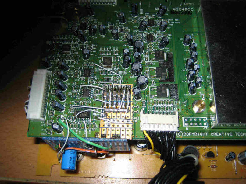

Hi Arasuk,
Can this be hooked for the regular dvd players
Yes it can. DDTS-100 has 3 digital, 1 coaxial and 3 analog inputs. It can be configured to output 7.1 or 5.1.
If you want to hook it up to a home theater system, two things must at least be done:
- replace all outgoing jacks with RCA-connectors
- if you are using subwoofer: DDTS has lfe channel out. But there´s no downmix from other channels into lfe. I think it is done in creatives separate speaker set. I have done a modification to the existing inverting lfe-opamp. It is now a summing opamp which sums all 6 channels and after it there's a separate opamp performing 4th degree lowpass filtering, matched to my subwoofers.
Look at the pictures.
For me, this is only a temporary solution. I'm planning to move the digital board in a better case, redesign analog part to use double sided power supply and replace attenuators and also redo the interface.
And if separate delays to each channels are needed: to put in an external dsp

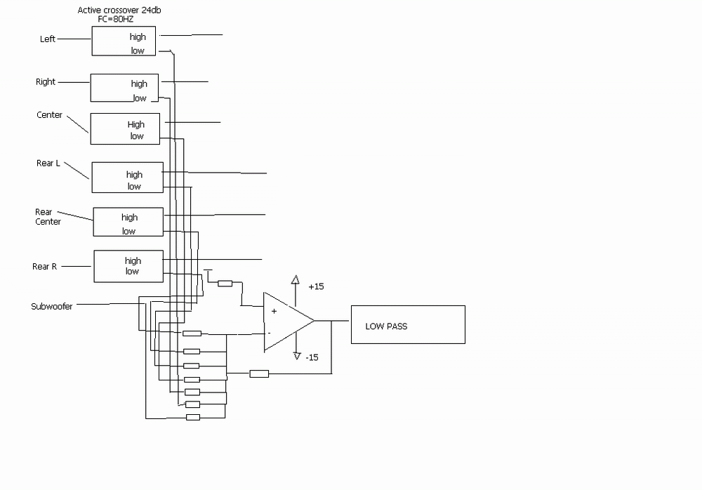

I also have DDTS-100 but I did't use it because i must finish my speaker first, I was not aware of downmixing problem until I find this tread so can you tell me if I can do this way?
Yes. I don,t use those separate 24dB active crossover filters, cos my speakers are small. For summing and lowpass part I use creatives own single supply.
Maybe DDTS-100's DSP56367 has downmixing features inbuilt in rom but creative does not take them in use.
Would be nice to now...

(Many thanks to benstrom for posting the original photos btw!)
