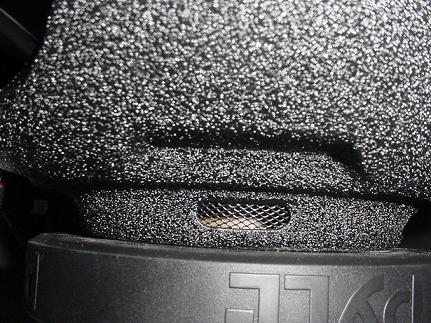

I'll definitely throw my JBL 1500GTI in the hat for this one. Purchased new at a department store for $175 . Originally priced over $1k, but they never sold it. When I ran across it, it had been marked down 4 or 5 times. 92db at 2.83V, 20mm Xmax, 5000W peak power handling. It should be able to do 120-125db anechoic sealed at 40-50hz. As long as the marked down price is acceptable, it would be hard to beat. In fact enter it into your sexiest category too. To me your other example looked cheaply made in comparison.
http://www.jbl.com/car/products/product_detail.aspx?prod=W15GTI&ser=GTI&cat=SUB
If it gets thrown out, then I'm sure I can come up with an array of cheapie drivers in the same total price range that will achieve a similar or higher result in a sealed cab. 8 of these for example
