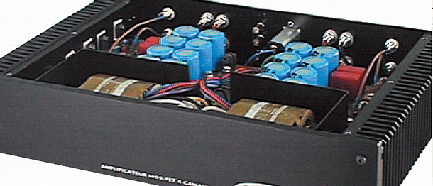

Hi all
I just wondering if someone has experience with these amp , or someone built already .
I'm planing to build these amp , so any advise would be good .
At the next week I will do the pc boards for it and buy the parts ..
If somebody know were I can purchase ECX10N16 or 20 & ECX10P16 or 20 please let me know .
I would like to use these type of lateral mosfets because a lot of fake 2SK1058 & 2SJ162 out there .
Regards
