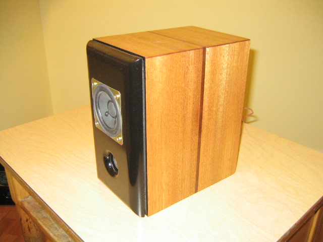

I just finished salvaging two pairs of Yamaha YST-M10 computer speakers. One neat thing is that each pair comes with an amp, so I put those in separate boxes. My project turned some ok computer speakers into something that actually sounds pretty decent in a larger room. I can now hear bass down to 50 Hz instead of 100 Hz, and I got rid of the "tinny" sound to them, plus they look a lot nicer. The drivers are the Yamaha 3" full range that almost all mid to late-90's Yamaha powered computer speakers had in them.
I had to stick pretty close to the original enclosure dimensions because I could not find any parameters on these drivers. I used 3/4 (19 mm) MDF, and the outside dimensions are 5 1/8 x 9 3/8 x 8 1/4 inch(130 x 238 x 210mm).
As I build more speakers, I figure I will eventually use these as surrounds or sell or trade them. If you come across any of these, they are worth looking into. They are also shielded, by the way.
