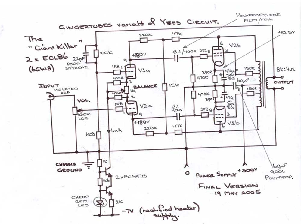

Did the final fine tune last night. I managed to get rid of the slight bass boom and the slight lack of "liveness" by decreasing local balanced shunt feedback - the 15K shown below (final value) was 2x 33K in parallel ( = 16K5) so the adjustment required was tiny. I found the same thing with the global feedback and the 100K value. 82K was too much 120K was not enough.
So for your edification here is the final ECL86 version. Its final because I've screwed the base on.
Ther must be 1000's of ECL82 and ECL86 Amps out there which could benefit from this circuit change.
Will let you know how the 12AT7 EL84 version goes. Will start it this weekend.
Woops who changed the image rules - back to photoshop to get it down to less than 1000 x 1000
Ian
One more evenings fiddling:
The balanced shunt feedback is nowhere near the 12dB stated above. Confirmed by Zout measurements with it in and out. The feedback voltage is being divided by the rp of the diffamp tubes.
Came down to an exersize in juggling the 15K which sets local feedback and the 100K which sets global feedback. The more local the less global required.
I found 2 "sweet spots"
1) 47K for local and 150K for global
AND
2) 27K for local and 100K for global
Settled on the 2nd of these 27K/100K after some further listening tests. The amp has now gone to its new owner - my cleaning lady to run her Polk R5s.
As far as rebuilding the Morgan Jones EL84 Amp to this schematic goes it means that I'm stuck with 12AX7 for the diff amp - I NEED that high ra to maintain local feedback levels.
My view after all these experiments is that you need about 6dB of local feedabck to push the output tube/transformer combination one octave lower (lower rp to drive primary inductance better) and one octave higher higher (lower rp drives leakage inductance and primary capacitance better). After that the sonic improvements are due to the current sourced diff amp front end AND perhaps more importantly the reduction in required global feedback.
P.S I ditched the original "Ring of 2" current source on the diff amp and replaced it with the Cascode Current Source, LED referenced, shown in the schematic above and got noticable improvement. I also tried dual LED reference in the CCS and found NO benefit. While this allowed doubling of the emitter resistor, by the time you multiply the emitter resistor by hfe of the bottom transistor and then by the hfe of the top transistor you are already passed the point of the Zout being dominated by device capacitance and so dual series LEDs for a higher reference voltage are of no benefit.
Ian
Update:
The Morgan Jones Ultralinear Amp is rebuilt to this circuit.
I found that the local feedback set resistor can be made too large causing the 12AX7 to saturate/cutoff limiting the output power.
About 47K is the maximum value. Currently running with that resistor set to 39K and NO global feedback. Sound is stunning!!!
Zout is 1.5 Ohms, Low frequency corner (at 4 watts out) is below 24Hz at which frequency waveform distortion sets in due to transformer saturation and upper frquency -3dB point is above 100kHz.
Ian

What to do with no 4ohm leads?
I'd like to build the gingertube ECL86 amp, but using 8 ohm speakers.
In gingertubes original, the feedback is coming off the 4ohm leads on the output trans. I'd like to use the Edcor GXPP15-8-8K. If I switched to an 8k:8ohm transformer, what would need to change in the circuit? (if anything)
netbug,
The shunt feedback will not change as the voltage swing at the pentode anodes does not change.
The voltage across an 8 Ohm load is however different from across a 4 Ohm load for the same output power. So the global feedback has to change.
We want the global feedback VOLTAGE to stay the same.
A bit of algebra.
Currently (4 Ohm load):
8 Watts into 4 Ohms (P=V^2/R) we get 5.657V RMS at secondary.
That 100K + 6K8 divider means we get
5.657 x 6K8/(100K + 6K8) = 0.36V RMS of feedback at that I/P tube grid. We want this same feedback voltage when taking the feedback from the 8 Ohm Tap.
With 8 Ohm Tap.
8 Watts into 8 Ohms we get 8.0 V RMS at secondary.
We don't want to increase that 100K feedback resistor since it is feeding the Miller Capacitance of the triode. We want to reduce that 6K8 instead.
So we want:
8.0 x Rx/(100K + Rx) = 0.36 V RMS
Cross Multiply to get:
8Rx = 36K + 0.36Rx
Gives:
7.64Rx = 36K
Rx = 4.712K
So replace the 6K8 with a 4K7 - That is all you need to do.
Ian

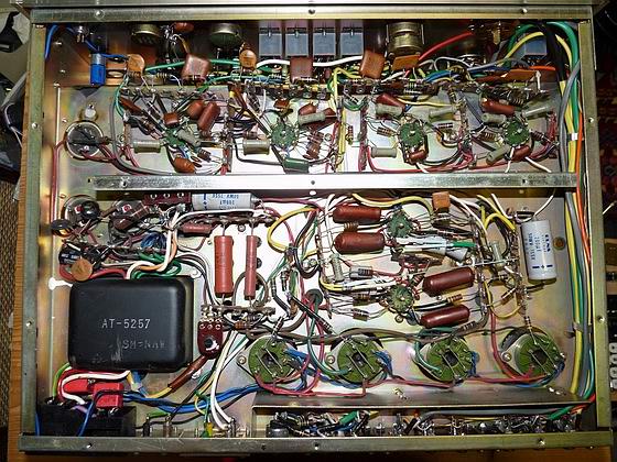

Hi Ian,
as a total newbie here - but with tons of vintage tube amps in my basement and all the NOS tubes u ever could dream of, i'm of course keen to learn if your nice concept spread above could fire up some of my goodies here.
From what i read so far, UL output stages benefit the most.
I currently try to refurbish, na - better to upgrade an old Pioneer SA 810. Unfortunately got no schematic, but since this one is point to point built, it should be easy to implement your design.
The diffamp uses 6AN8 which measure pretty low, so I'm thinking to swap for 12DW7 (availlable as ECC832 by JJ), using the AT-triode or the AX as driver. Any recommends?
greets
Verne
