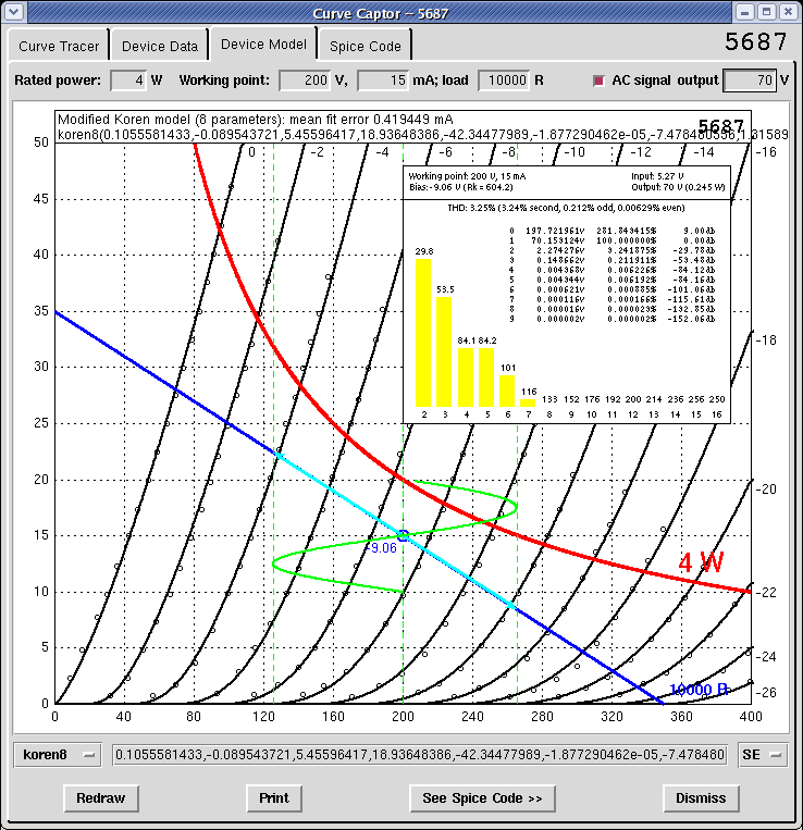

I am looking for a few people to beta-test the vacuum tube modeling software I wrote (for my own use), to iron out bugs before I do a public code release. Basically, it can build Spice-compatible models and do simple bias point/signal analysis calculations from the traced tube data (either from datasheet curves or obtained elsewhere). See attached screenshots for examples...
It is developed on Unix platform, but as it is written in Tcl/C should be portable to Windows (any takers?). Documentation is non-existant at the moment.

It requires Tcl/Tk for GUI, m4 for macro processing, standard C compiler (tested with gcc and icc), and FFTW libraries for distortion analysis (www.fftw.org). All of these are available on many Unix clones...
Models are macro-based and can be easily adopted to your favourite flavour of Spice. You do not need Spice installed to run Curvecaptor - it has simple waveform analysis build in (at much better precision, too 🙂).

I did my own software using Matlab to model tubes and calculate SET input and output stages in real time while dragging the loadline all over the graph. I used the regular Koren's model, I found however, that in some cases the model collapses and the best parameters give out real and imaginary components when plugged into the equation to model the curves. It doesn't happen with all triodes, but some. Using only the real part of the answer give a good approximation, but some anomalies happen at the bottom of the curves (not of much importance as I would never operate tubes there).
You used an 8 parameter model. I wondered if you modified Koren's model to solve similar anomalies of the model with some tubes. If that's the case, could you comment on the additional parameters and pass along the model?

Yes, original 5-parameter Koren model
sometimes runs into trouble because of the square root term. Actually, most improvement to fits in Koren model comes from the Kp parameter, which can model remote cutoff in triodes quite well. Dropping the square root gives the simpler 4-parameter model,
which is almost as good as the original, but more robust. Just adding more parameters will not necessary make the model better. I spent a fair amount of time trying various functional forms and trying to find degrees of freedom which will help to fit "difficult" tubes. The model that performs best overall adds four parameters to 4-parameter Koren model above
Depending on a tube, the fit might be improved by a factor of two, or hardly at all.
4-parameter Koren model is probably good enough for calculating working point and signal amplitudes. The reason for more complex models is to try to get the distortion analysis right. Simple models give unrealistically small distortion figures.
In Curvecaptor, you can choose the model from a menu and see the differences in fits.
Code:
Ip = K * [Vp * log(1.0 + exp(Kp + Kp*mu*Vg/sqrt(1000.0*Kv + Vp*Vp)))/Kp]^gamma
Code:
Ip = K * [Vp * log(1.0 + exp(Kp + Kp*mu*Vg/Vp))/Kp]^gamma
Code:
Ip = K * [Vp * log(1.0 + Kc + exp(Kp + Kp*(mu+nu*Vg/1000.0)*Vg/sqrt(Kv*Kv+(Vp-Vc)*(Vp-Vc))))/Kp]^gamma
