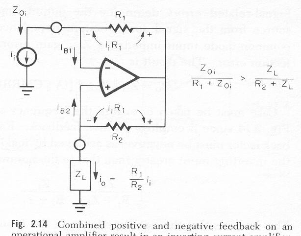

Hi Mauro,
Very interesting and ingeneous ideas! I think that in pratice there may be some brawbacks, like:
- power wasted in the current sense resistor;
- the need for a differential input (the input R is between inputs and not between an input and gnd). Of course, you may wan t to use diff input signal.
Just to give you some - admittedly VERY basic ideas - I attach two schemes that get around this. They are from "Designing with opamps - application alternatives", by the former BB lead designer Gerald Greame.
Jan Didden

... and the other one:
BTW, There was some comment above on the stability. The LM3886 may not be the best one as is it is not unity-gain compensated - I see some signs of those potential problems in your compensation networks! I don't know a better alternative but it may be useful to look around to get the best GBW available.
Jan Didden

Not I went to school in founding the circuits that show me, but I think that the problem of the dissipation of the power on the "sense" resistor remains ( R2 in the schemes ) and this configurations are a lot of difficult by stabilize on LM3886. In more, with the bridge that I have chosen, I prepare of a differential entry ( on R6 ) and of the "floating" exit that is able connect to any "reference".
LM3886: he is hard to please to compensate, and true. But I the have done. We are able argue much on our choices, but I am a lot of pragmatic: This circuit you allows to study the stasis technical using your preferred VAS, and works perfectly. If they use a VAS with 0.00001% THD, to the output, on the load, you will have that value, and the THD of my bridge comes annuled. Is a lot of useful to analyse the limits of my buffer or is better think to a reference VAS ?🙄

Mauro,
You are right, also in the basic schemes the problem of dissipation in the "sense" resistors remains and is even larger than in your case, I overlooked that.
I think I understand your reasoning on the "annuling" (cancellation?) of the THD, but wouldn't that require precises ratio's between the various feedback resistors in your output stage?
Jan Didden

Janneman: The yours are good questions. As I have already said in other thread, my translations in English is very bad, and I do labours to express clearly my concepts. I hope that you understand at least the principal things.
"sense resistors": to clarify, my circuit has 2 "current sensing resistors ", one of power (R5) that is directly on the load ( and dissipates a discreet power ) and one of signal (R6) that is fundamental but it has only the limit to reduce ( case of strong load ) the swing of tension in output on account of the V=R *I relationship. I don't set me a lot of problems on this factors because the "normal" amplifiers have all on the power run a resistors, and much them insert in series to the power signal to reduce the problems of capacitive load.
Ratio feedback: Because they "stasis" condition ( or effective THD control ) are good, they serve of the "conditions":
Ivas << Ibuffer ( my=1:1000 but is enough 1:100) and current bridge with high input impedance ( and relative high output impedance, compared to load). Better we respect this conditions more the "stasis" effect will be exploitable. The planner is able move in this parameters using the formulae and the variations that I have already make a will in the scheme, and if has adeguate tools is able even works on R6 to increase or decrease the Ivas:Ibuffer relationship and optimize the output. The proposed circuit works much well for an use generic in combination with launch types of VAS, without changes, but a good planner has to have borders of amelioration.
