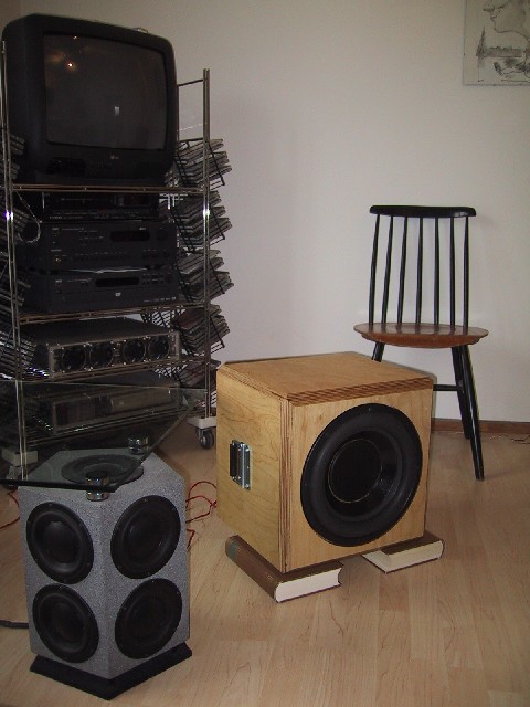

With slow baby steps I am going ahead with two sadhara-cubes.
Sealed design. 30 litres netto. Linkwitz transform down to 12Hz (natural resonance of the sealed design would be 42Hz).

Here a pic of one cube.

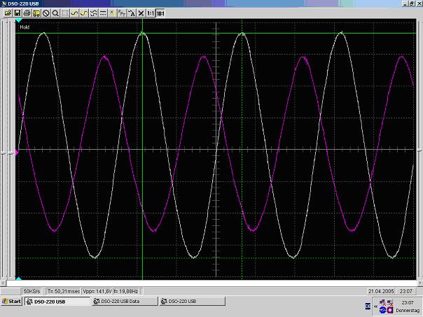

Below is the screen shot of the excursion test with 142Vpeak-peak and 390W. Under this conditions the voice coil heats up quite fast. Already after 10 sec. it exceeds 150°C .... well, I decided not to run it continuosly at this load...
White trace: Voltage across speaker, 20V/div.
Colored trace: Current through speaker (inverted polarity), 5A/div.
