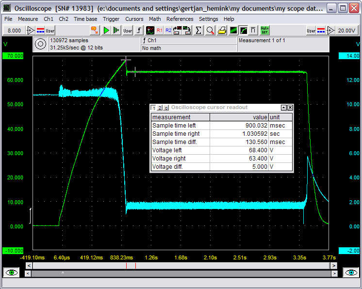

The UcDs are not yet connected. The overshoot is caused by the fact that the feedback loop is working and tries to maintain a 63V output voltage while the softstart circuit in the SG3525 chip limits the startup speed. So both circuits are fighting against eachother resulting in the error amp giving its maximum 12V output voltage (clipping of the integrator).
The green line is the plus rail output voltage. The blue line is the output voltage of the error amp. It comes down when the output voltage exceeds about 63V, but it takes time since the integrator was clipped to 12V, therefore the overshoot. The error amp compares the reference voltage (5V) with the output voltage via a voltage divider and a compensation network. This 5V is applied to the error amp well before the supply really starts up, therefore, this effect of the clipping integrator (error amp output) takes places.
Gertjan

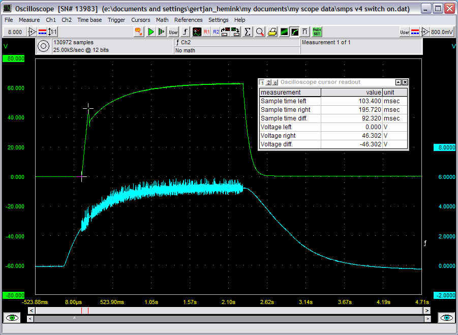

I set the softstart cap back to its original value (10uF) and I cut a trace on the PCB to be able to implement an RC delay for the Vref that goes to the error amp. I took an R of 15k and a C of 22uF giving an RC time of about 330ms. The result is attached. Now the softstart is faster than the reference voltage and there is no overshoot. Well there still is, but it is at a much lower level as you can see. The softstart results in the output voltage ramping from 0 to 46V in 100ms, after that it drops a bit and then gradually goes up to 63V. Basically following Vref (blue trace). The noise on Vref is due to the scope probe and GND wire of the probe being seperated about 15cm or so and thus picking up switching noise.
Since the output first rises with a rate of 46V/100ms, this would mean that the supply needs to supply a current of 4.6A when I hook up 10.000uF caps to each rail. This should be not much of a problem.
By the way, after some measurements (not shown here), I concluded that the input of the SG3525 switches from 0% duty to 50% duty (with is 100% duty in case of a full bridge that this SMPS has) for an input voltage of about 0.9V (0%) to 2V (100%). So this means in my case that the gain from input of SG3525 is about a factor 130-140 as my rectified mains reach about 260-280V and the output transformer is a 28:28 center tapped. This is usefull info to improe my simulations with switchcad.

Hi Pierre,
I don't think I can answer all your questions. Anyway, I'll give you my thinking here.
1. I don't plan to use a smaller filter coil, the 350uH one that is used now looks very heavy duty so I leave it as it is
2. I plan to increase the output caps for a couple of reasons: a bigger cap gives your more power reserves for very quickly changing loads; it could also prevent/reduce power supply pumping; it reduces the Q factor of the LC filter which makes it easier to optimize the feedback loop since the phase response would be more gradual.
In fact, tonight I plan to measure the open-loop response of the SMPS by cutting out the feedback loop and apply a signal to the input of the SMPS input directly. This allows me to get accurate data about the gain which I now have estimated at about 130 and it also allows me to measure the response of the combination of the SMPS and LC output filter. I plan to measure the response with the standard caps and big caps and also with a few different loads (read lightbulbs). With that info I plan to do simulations to determinethe optimum feedback netwrok for my application.
I plan to keep using feedback since that way, the influence of mains voltage variation can be suppressed and also the mains ripple (100Hz) can be suppressed by the feedback. As a result, the increased mains ripple suppression will make it look like you have bigger output caps. The feedback loop will be active for lower frequencies, so for lower frequencies that need most of the power, the SMPS will actively regulate the output voltage to stay stable. For higher frequencies, the power is drawn directly from the output caps as the SMPS will no be able to regulate fast enough at higher frequencies.
With the SMPS I hope to create a very stable strong power supply that is able to deliver stable power and lots of current especially for the amps that drive the woofers. Since the current that is drawn by the amps for the woofers is relatively slowly changing, by proper design of the feedback loop the SMPS should be able to regulate that nicely.

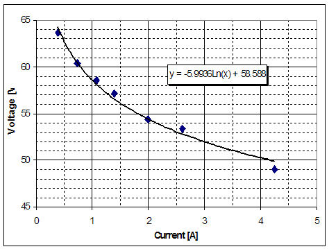

Hi Pierre,
I did some measurements yesterday and today using the SMPS unregulated (cutting the feedback loop and apply a voltage to the input pin of the SG3525 chip.
I found that I need to apply about 1.7V in to get about 65V out, this is with a total duty cycle of about 50%. I checked the gain, with my relatively low mains voltage of about 100V, the gain around 60V out (checked with a square wave of 2Hz on the input with 100mV amplitude and offset 1.6V) is about 45. I had earlier estimated a higher value of about 130. However, the gain is not linear over the whole range, so I checked the gain around the working point where I plan to use the supply (around 60V) there it is about 45. Will be a bit higher when you use it with 115V in or 230V in as intended.
I varied the load current from about 0.4 to slightly over 4 A. I used dummy loads that I build with a collection of 82Ohm 20W resistors that I had bought the other day to make a dummy load for amp testing. Some of the resistor had to endure about 40W to be able to reach that 4 A output current, they survived, they were only stressed a short time, say 10-20 seconds at a time and all the resistors were glued to an aluminum plate.
The attached graph shows the unregulated output voltage of the SMPS versus the load current. You can see that the voltage drops quite significantly. With a load of about 4A (about 400W), the 100Hz ripple at the output has become about 2.8V peak/peak (1V RMS). With additional 8200uF caps at the output, the ripple reduces to about 140mV RMS.
So I would not want to use this supply unregulated.
You can also see that the Vout does not drop linear with Iout. This means that the output resistance is not constant and varies from about 20 Ohm or so for low currents while it goes down to about 1.4 Ohm at 4A. I estimated it will go further down to 0.6 Ohm or so at 10A. I estimated the resistance from the slope of the curve (dV/dI). So for modeling of the feedback loop, it is probably best to model the whole thing with an output resistance of 0.6 Ohm since that will give the highest Q factor of the LC filter and therefore the fastest phase change.
Best regards
Gertjan

Another, more simple solution that probably also works (albeit with less phase margin) would be to lower the current zero and pole to a lower frequency to reflect the lower LC resonance frequency that you get with bigger caps. However, then the loop gain at 100Hz will be lower than it is now, so the 100Hz mains induced ripple will be less suppresssed by the feedback network, although it will of course be suppressed by the bigger caps. That is why I prefer to add a zero, so keep the gain at 100Hz to get the optimum in 100Hz ripple reduction.
By the way, maybe you have read this in an earlier mail. I added an RC (15k, 22uF) delay for the reference voltage that goes to the error amp to avoid the overshoot in the output voltage when starting up.
Thanks and best regards
Gertjan
What Reinhard says makes a lot of sense.
Ghemink tested the supply in open loop, but forcing the PWM to be less than 50% by inserting a given voltage in the SG3525 input. So the transformer+filter wasn't working in an optimal way, because it was not regulating neither it was not working at 50%, that's why regulation was so poor.
I am almost sure that, if you tie input to GND, so the PWM controller goes to its maximum duty-cycle, you will get a higher output voltage (can you confirm what voltage exactly, Ghemink?), but you will have much better load regulation, right?
I have also some experience with DC/DC for cars (12V to +/-40V), unregulated, and it was so stiff that regulation was not needed, at least from the load point of view (of course line regulation is null). But it is the same with a conventional offline linear power supply, isn't it?
Pierre said:What Reinhard says makes a lot of sense.
With 0V at the input of the Sg3525, nothing will happen, it will have 0 output. The sg3525 starts to work from about 0.9V at its input, I think it will give a 50% duty cycle at around 2V in or so. Effectively, the duty cycle will be almost 100%, so output voltage would be about 130V, this will blow my caps and I don't want to try that.
I will soon try to modify the feedback loop in the simplest possible way. Not adding an zero, just keep it as it is, just increase the size of the cap in the feedback loop to compensate for the lower resonance frequency of the LC filter with the bigger output cap. This should then still work with the original caps as well.
Best regards
Gertjan
