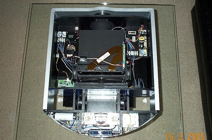

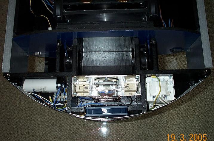

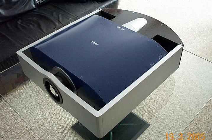

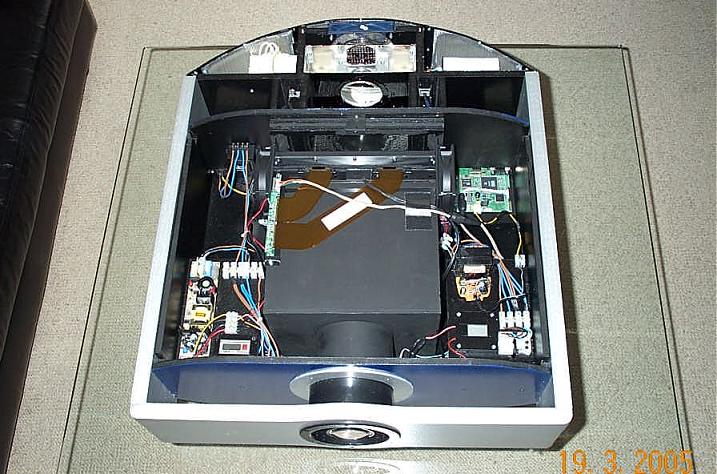

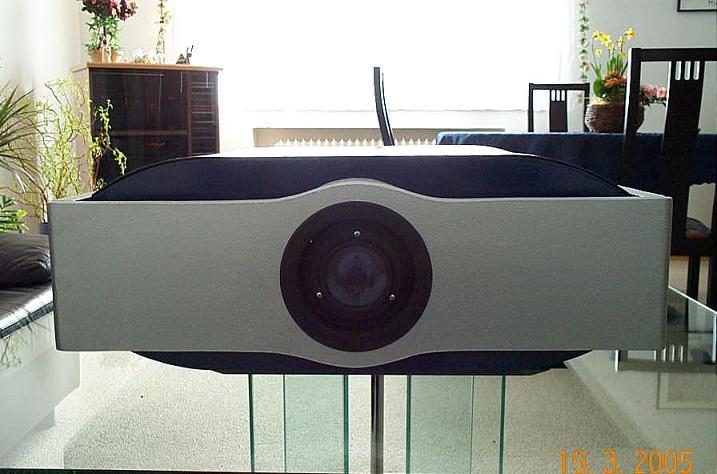

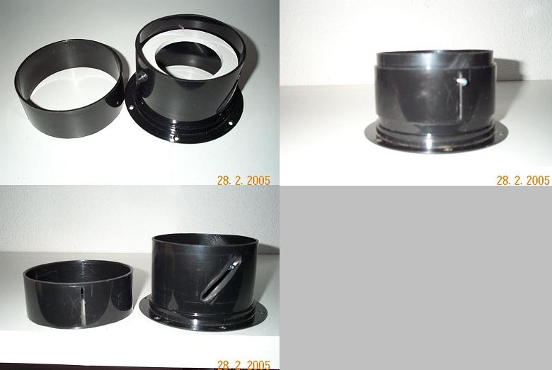

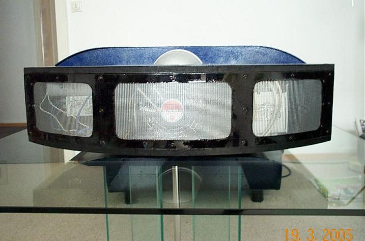

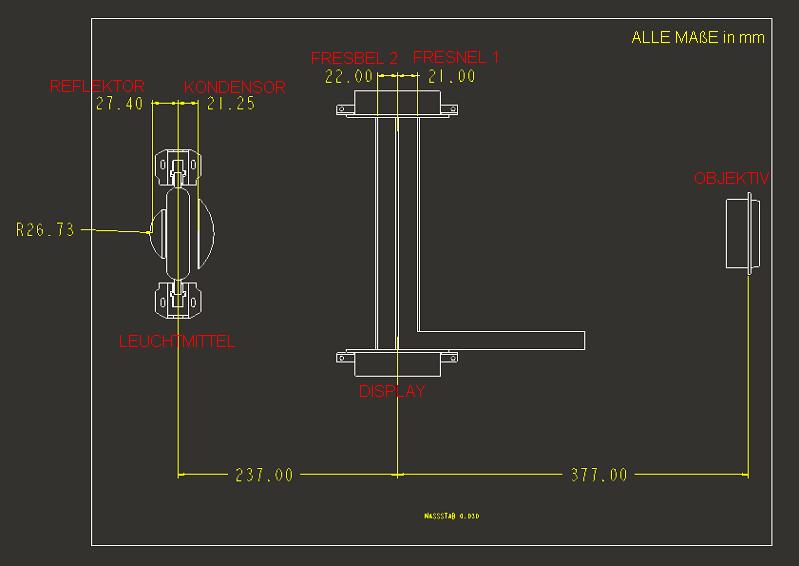

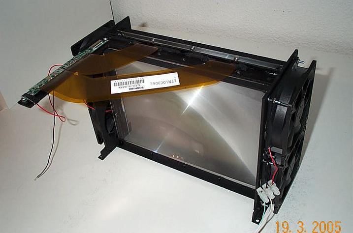

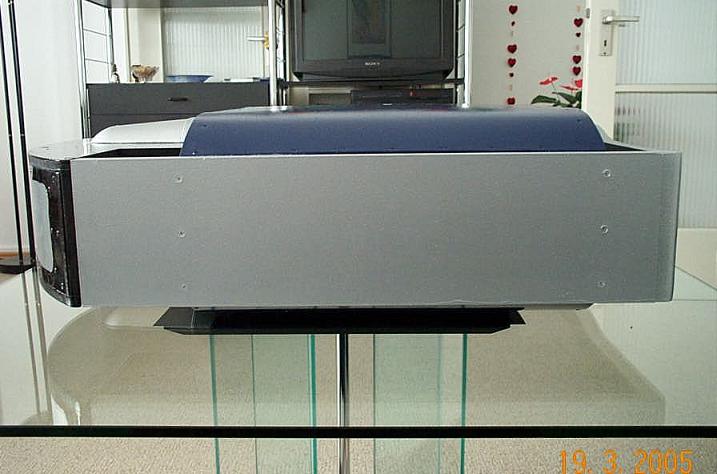

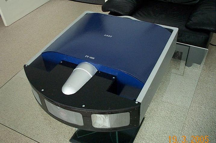

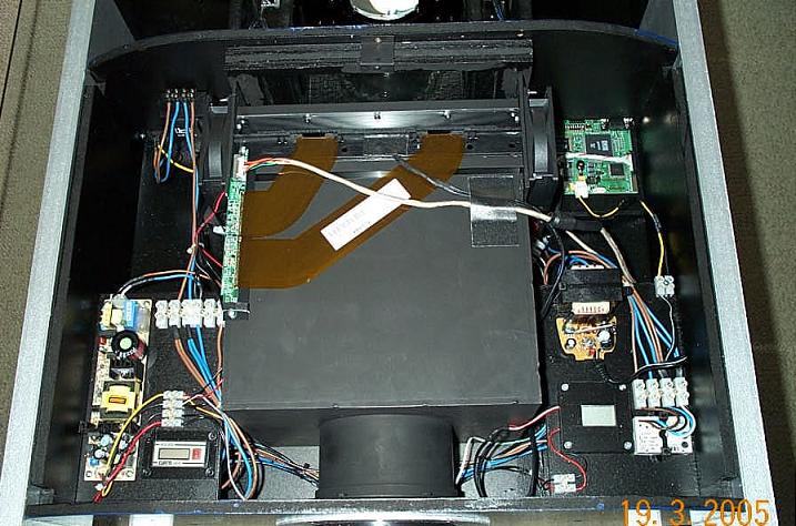

Finally i am able to present my finished project.
First of all i apologize for my poor english, but i hope everything is understandable and pictures speak more than words 🙂
The product name ist ANDY - FV005, this stands for my name and final version 2005.
My inspiration has been the SONY Qualia-004
Here are the specs:
- TFT-Display: 10" Toshiba 1024x768 + Controler 1
- Osram Powerstar HQI-TS 250W +VG+ZG+KS
- Reflector from OHP
- Condensorlense
- 310mmx310mm Fresnel
- 345mm Triplet Objective
- IR Filter (210mmx175mm)
- Wood/Forrex/Alu case: L/W/H: 72 x 60 x 23 cm
- 2x92mm Alu Sunon Lüfter @230V, 1x120mm SilentMaxx Lüfter @6V, 4xNoName Lüfter @6V
- weight app. 12kg
Here are some pictures

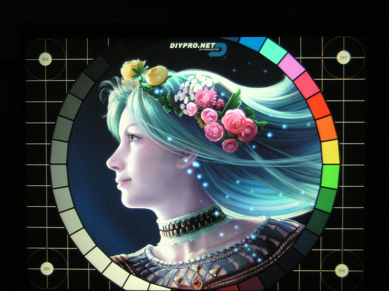

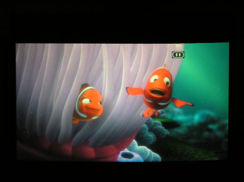

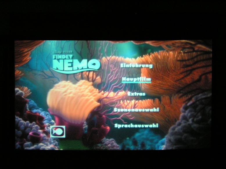

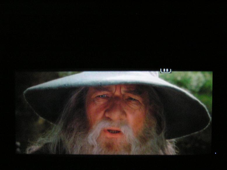

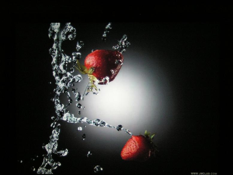

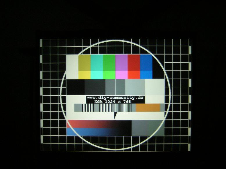

all pictures were taken with the olympus c-750 ultra zoom; shutter was at auto. no picture has been worked over digitally besides compressing it to 800x600 res.
the diagonal is 1,90m (75"). The picture is 1,50m (60") wide and has 1,10 (43") height.
all the following pictures were taken in a totally darkened room.
finally some results; first we start with the korean test pictures
