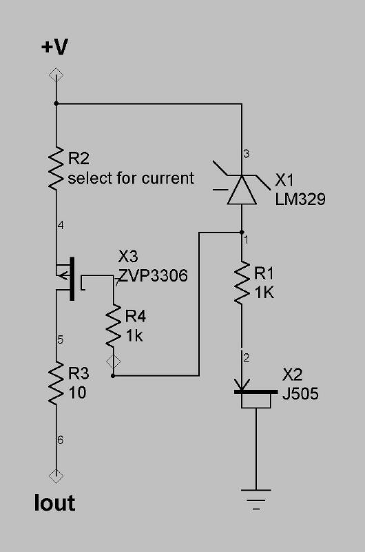

Since it's A75 I have available 50V regulated power supply for the input stage. I was thinking about using it for differencial pair current source and somehow improving it as well. Any suggestions?
Any improvements when current increased? What would be recommended value then?
The drain resistors (392 ohm) would be connected to output stage supply.

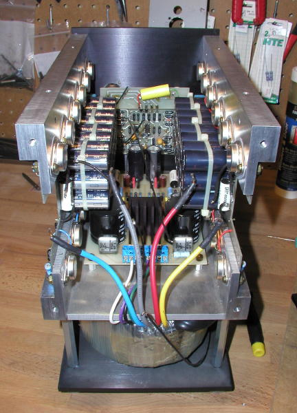

It's a shame that something so nice has to be dismantled, but some people do anything for better sound.😉 This might well be the first DIY Aleph with TO3 output devices. I'm also playing with idea of turning it into Aleph X instead of Aleph2, don't know yet.
I like the way the transformer is isolated from the rest of the circuitry. I also used special damping materal for vibration reducing. Also I used Panasonic HFQ capasitors for PS (quite a lot of them).
It's been my best work so far and it looks like it still remains with an upgraded interior.
Checking other threads I noticed that Harry placed 5 green LEDs instead of zener with a small bypass cap. Is that the best that can be done?😉

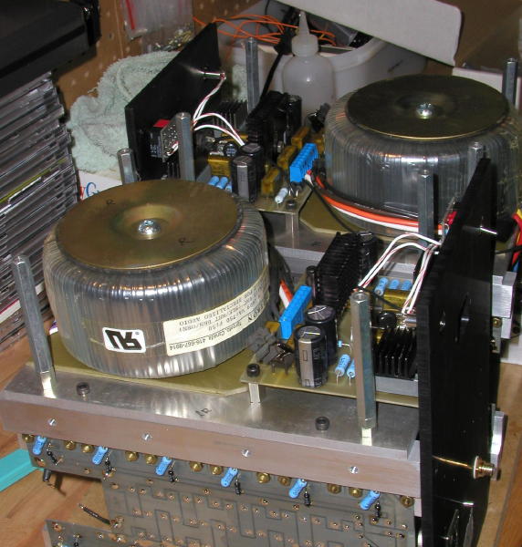

The heat sink are removed. This allows for easy access in case of repair, modification. As you see mounting TO3 devices is not as easy as those plastic ones and special bars had to be used.
No......... By the way do not power the front end current source from a seperate supply from the output stage or you can end up with the turn on/off thump from hell if the supplies come up or down at different rates!

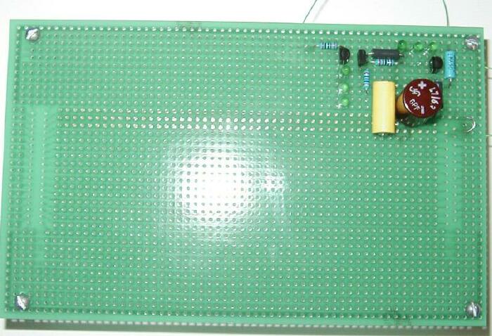

Yes and those of us that build ugly circuits are embarrassed to post them........ I actually had to go out and buy nicer looking protoboard......

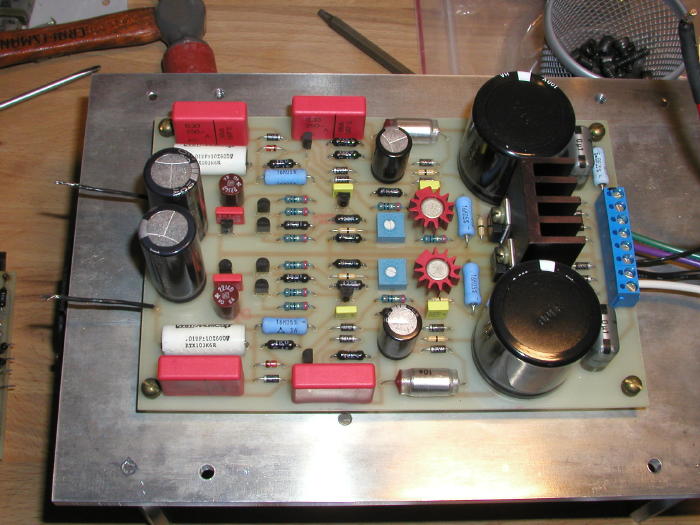

H.H.
The LM329 needs a capactitor across it. Select anything good looking ... I usually go with about 1uF bypassed by about .01uF, all film of course.
However, the proposed design is not optimal. You could use an additional bipolar transistor to act as a feedback device to increase impedance of the current source. I think NP posted something on that a few months back in response to my suggestion of using an op-amp (for maximal output impedance and minimum power loss).
If your sense resistor is large (you drop several volts), your current source will be fine. If it it small, you might want to replace the MOSFET with a BJT, use a small BJT in a feedback configuration, switch to an op-amp (something tells me you don't want that) ...
BTW, beautiful work. Your mechanical skills are out of this world!
