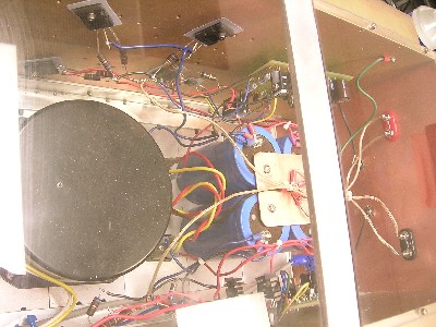

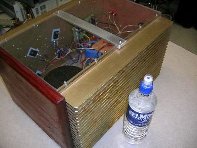

Hey Mike's KSA-50's up and running! Good for ya. How's the sound? Tell us more. 😉
Whats your emitter resistance and the voltage across each one in mV?
Bill I think Mike wanted to begin a new thread for completed KSA-50's because the KSA-50 PCB thread is kind of long now.
The emitter resisters are .1 ohm, 30 mv across each one. I had them as high as 75mv but I could not touch the amp after about an hour. The amp sounds better than expected. Not as nice as the Aleph in the midrange, but much more punch in the low end.
Fred thanks for the heatsinks.😀
75mV is 81 watts class-A with 160 watts idle dissipation. :hot:
30mV is only 13 watts pure class-A but with 60 watt dissipation. :whazzat:

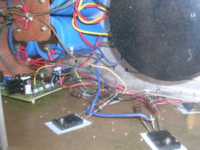

for 50 watts pure Class-A, 59mV is needed. But as you say, we dont know if your heatsinks can take it. Also these calcs were done assuming you have 3 output pairs, I see 2 in your pics...😀
I am curious, how did the mids sound with the 75mV setting?

Jan and Troy thanks for the board. K-amps thanks for the transformer. Bias 600ma, rails 35 volts

I am only using 2 sets of outputs (mjl 4381,4302). I have a few different pre-amp that I have tried. Some Magnepan and home made speakers.

Have you only basic imagination about internal wiring of an amp ? With this " wire salat " you can't wait miracles - miracle is fact, that this connection is able to work. :cannotbe:
I was talking about the midrange of the Aleph. I said this is a very nice sounding amp. I like it very much.
Miracles do happen. The imagination designs the amp. I work with what I can find. Thanks for the reply.

Looks like a bunch of Spaghetti .......in a box...........

No fans
