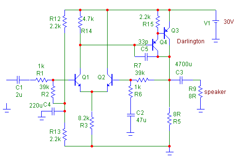

I do like a challenge. 😉
Select both devices for high beta. I assumed 50
on the power device, and 100 on the driver.

NP, will your circuit work?
With a +30V supply rail and the collector of the output transistor at +10V, the output stage quiescent current will be 2.5A. If the output transistor has a gain of 50, its base current will be 50mA. The base of the output transistor will sit at about 1.9V so there will be a current flow through the 220R resistor of nearly 9mA. The total current through the input transistor should therefore be 59mA.
The maximum available voltage across the 1k collector resistor is somewhat below 28V so the maximum current through it will be under 28mA, less than half that required.
If output transistor collector voltage is increased to 20V, which will halve the quiescent current (this will still be sufficient for 6Wrms into 8ohm), the required current flow through the input transistor will be reduced to 31mA, still greater than that available through the 1k collector resistor. Also, the peak positive output excursion becomes less than that required to meet the power specification. Adjusting the values of the output stage emitter and collector resistors to reduce the quiescent current, whilst retaining the same gain and collector voltage, will overcome the voltage excursion limitation but will produce a similar result with regard to the input transistor current.
The conclusion? The 1k collector resistor must be significantly reduced in value (or omitted completely).
Also, the input impedance of this circuit will be around 2k5, considerably less than the 33k Rudy was seeking.

PMA said:
In fact the amp shown above has a serious flaw - very limited output voltage swing, especially in a negative half wave. It can be improved by adding three diodes in series with Q4 emitter lead, but anyway it is impossible to get more than some 2Vrms from this circuit.

simple BJT amp already built 🙂
I was very curious how the circuit that I had shown here yesterday would work 🙂. So I have built it and it runs quite happilly, exactly according to my yesterday's description. Negative output halfwave is very limited, because of the Darlington 2Vbe influence to Vce voltage of Q2. But add 4 diodes (I used 1N5408) in series with emitter of Q4 and you have a working amp. It will give you some 1W into 8 Ohms, then there is a very very soft limitation (mostly second harmonic) to some 10 Vp-p voltage swing. The amp is very quick but not very stable, so put a 470pF cap between base and collector of Q3 and everything runs well. You can increase R5 to some 15 Ohms/10W (if R5=8 Ohm it must be 20W) not to produce so much heat 🙂.
Pavel

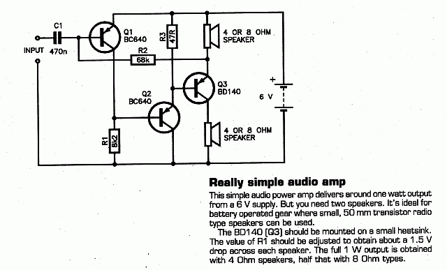

This circuit is seriously wasteful of the supply voltage, as
even with perfectly ideal transistors, the maximum output
per speaker will be 1 V rms, which is 1/8 watt for 8 ohm
speakers. A more ordinary output stage would give you
1/2 watt.

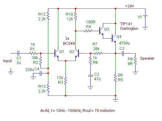

yes, and still only 4 transistors.
And almost 4 Watts Out/ 8 ohm
Needs V+ 35 Volts for 4 W.
Will have a Idle power consumption: 35x2A= 70Watt
Effiency: 4/70= 5.7 %
But this one is not bad ...
😉 I would put Collector of Q4 to 0V-line. 😉
Q4 will work more linear 30V all the time.
I lose a little Current from Q4 into load,
but that is anyway not so much, that it is worth having
such a darlington coupling.
I say let Q4 get some REAL working space.
