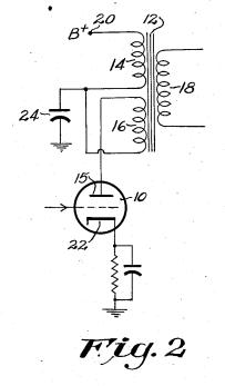

I recently read US patent 2895019 by M.Farber
about compensating opt SE trafos to cancel the constant
flux as in PP transformer.
This is achieved by the use of a choke or
a capacitor and, if true it is a great advance in
SE tube amp design.
I carefully read the patent but I am still very doubtful.
opinions?
thanks

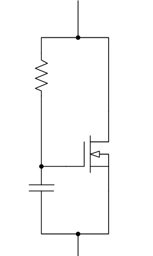

An FET gyrator
I have used this very simple circuit several times. It works amazingly well considering its simplicity (depends mostly on the choice of FET).
DC Voltage drop is more or less equal to Gate Threshold (typically 5-10VDC) think of an L in series with a zener.
I have not developed an equation for the equivalent value of L, it is dependent on transconductance and operating point. Start with a R of 50K or so and a C of 10uF this will get you low in the audio band.
Power switching FETs are a poor choice, too high a gate charge. Higher transconductance is better of course.

This is my doubt for fig.2: doesn't the "bypassed" half of the primary appears like a "parasitic load"?
I mean, the tube is loaded with 1/4 of the load reflected from the secondary, it's ok, but what about the bypassed half?
I can't focus this point...😕
Figure 2 merely places an LC filter on the core of the OPT. I don't see why this would not work?
in fact, Silurato, a zero Ohm load regard AC, and the output tube
will see zero ohm. so, no signal.
unforunately, it also prevents volts from appearing on the bottom winding, through transformer action.
Exactly, Sch3mat1c
I simulated fig.2 configuration and it does not work.
Dont'forget the secondary winding. The reflected impedance is the sum of RL (n1/2)squared and Rcap (n2/3) squared. This is because the conservation of energy law V1*I1=V2*I2+V3*I3
Exactly, Sch3mat1c
Why trust spice more than simple maths? To dissipated any doubt I run a simulation and in a short time I'll post some results pictures at this address:
