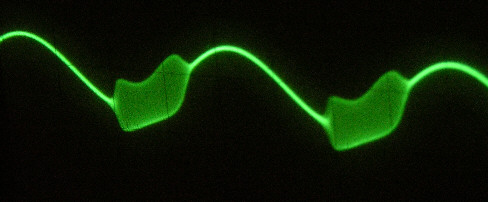

Bernhard said:Ok, looks like it is unstable. Even before distortion is noticeable it starts to show oszillation packages. (?)
Bernhard,
The oscillations stop at the point where the other half takes over. Could it be that the bias is too low, that it is in class B instead of class AB? The oscillations could trigger the protection circuit and/or show up as offset on the DC meter. The difference in Vbe also points that way.

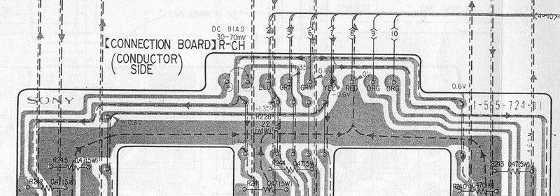

You verify the correct bias setting by measuring between 30 and 70 mV across two Re's in series, like R140-143, or R141-1444, or R142-145, other channel: R240-243, R241-244, R242-245.
You can measure that on each power stage sub board: put the amp front of you so that the sub-board looks like a 3-legged bridge, the "legs" connecting to the three individual power transistor sub-sub boards. The bias test points are the top left two pads of the "bridge", where no wires are connected.
Jan Didden
To adjust the bias, turn RV202 (R-channel) or RV102 (left channel).

thanks, I measure 6,2mV across the pads of the working channel, and 3,6mV on the bad channel.
Are those pads equal substitutes for those resistors in series you mentioned ?

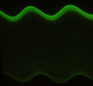

Bernhard said:
On the bad channel it is also -64V but when distortion starts, it breaks down to 0,2V. The 100 ohm resistor seems to be ok.
Not anymore, maybe that was an error of me, but in the beginning I measured 0,2V also without signal.
But the emitter of this transistor got 0,7V while it is -0,5V on the good channel.

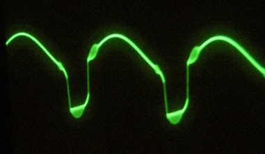

On that leg the ac sine signal has spikes while it is a clean sine on the good channel .
Spike:
