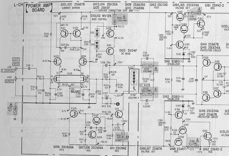

Ok,... or better: Not ok...
After putting a BD244C in place of the 2Sa835 it is still the same.
Just ordered 2 2SA835 for 8 EUR today
Now I adjusted the offset pot, this works, and makes those 0,7V on both emitters disappear just a few mV left.
And sound is always distorted.
Maybe the NPN is dead ???
There is for sure no current flowing in the driver stage but why does offset adjustment work ?

Now I measured C142 both sides voltage to ground, the good channel gives +1,2V and -1,2V and the bad channel +0,6V and 0V.
So is it wrong before the driving stage ?
Edit:
So the NPN is not dead and conducts, and the PNP is also not dead but does not conduct. (?)

Jan, thanks for the schematic.
Bernhard, if I may…
Usually, when I repair amps like that, I start measuring the safety resistors.
Lots of them here so make sure you discharge the supply caps before measuring as the remains of voltage have great influence on ohmic measurements.
I possible even disconnect the caps.
Somewhere you said R136 was 250 ohm or so. Could be leftover voltages. Or it could be broken.
Then I check all diodes. Mostly fairly simple with a diode meter. When in doubt I take them out or check the schematic for a low resistance parallel.
Then I check the transistors for shorts. All of them. Again when in doubt I unsolder them. Sometimes it’s a time consuming job but in many cases the only way.

Hugo,
very good idea...
R121 was very dead.
12k instead of 220.
Replaced it and bias is ok, distortion gone.
There are some other resistors already weak, as the mentioned 100ohm that measures 250...
So the other channel with weak bias will have a similar problem.

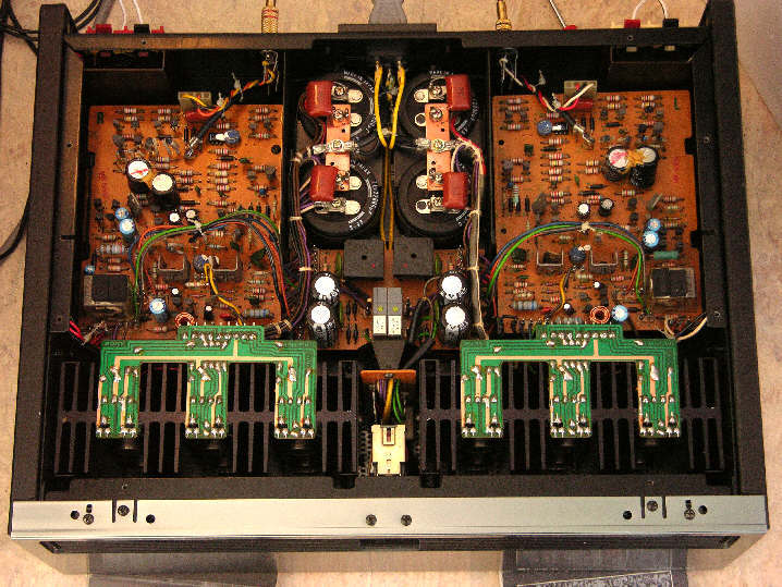

This is the amp, but mine is in nice cosmetic condition

megajocke said:I suggest you check that current source around Q111. I had a Technics amp with a similar problem (but without the oscillation). The amplitudes in the bad channel were much higher and the problem was a bad connection in the current source for the VAS.
How true...
Hope the low bias in the other channel is also dead resistor.
But already sounds nice.
So megajocke was correct about that CS.
