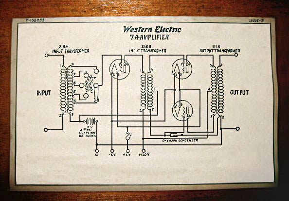

Konnichiwa,
Well, I think it is time to give soem TVC background....
Some time in the dark days last millenium rumours of a Product that was hideously expensive and hideously looking but sounded great reached the Joenet. Not much was information was available except the thing was a transformer and called Silver Rock (but cost it's weight in 22 Carat Gold!), in fact they had resurrected a level control approach first shown by WE in the 1920's.
This originally got me thinking and the benefits of using this principle for a passive line controller where immediatly obvious. No specifications where available on the SR, so I had to think of my own.
I first approached Sowter in the UK about arranging a one-off production run of such devices for a group order of the Joe-Net and the London Live DIY Circle. I decided to specify the nominal impedance of the line controller transformer as 10K, based on a number of considerations (I'll come back to them below).
For a number of reasons (mainly Sowters refusal to make what we wanted and our refusal to buy what Sowter wanted to make). The group buy blew up. At any extent, a year later or so Sowter made a Volume Control transformer available, with the exact specifications I had originally asked for. This one was soon being "improved" by Sowter, based on listening to the "improvements" they seemed more related to manufacturing economics and measured performance than good sound.
Once I got in contact with Stevens & Billington Transformers I got them to make a "no compromise" design to the same specs I had given Sowter and the TX-102 was born.
Now to the specs.
I first of all considered (and still do) the following basic truisms:
1) The ideal linestage has an infinite Input impedance
2) The ideal linestage has a zero output impedance
The aim of the TVC's which I specified was to approach this ideal as much as possible, especially in the midrange.
If you use any significant level of attenuation on the typhical TVC your load on the source will become very high. If for arhguments sake you use a TX-102 into a 10K load and you apply 12db attenuation, your input impedance of the TVC will become around 160KOhm in the midband rising further as attenuation increases.
At 20Hz the inductive reactance limits your input impedance to around 50KOhm, but even that is quite high by anyones accounts. However, importantly the Midband where the ear is most sensitive sees very little load on the source and thus low distortion.
Now let us look at the output side of things. If we have a source with 3k Output Impedance (not ususual for many Valve Circuits) and we attenuate 12db, what will our output impedance be? Around 200 Ohm, this will drop further as attenuation goes up.
So what we have created is in effect a "gearbox" that attempts to load the source as little as possible while making ALL the power drawn from the source (minus a small amount of loss) to the load. The low load on the source minimises distortion there and the low output impedance allows a TVC to "drive" their loads and cables.
Much of what makes typhical TVC's sound the way they do is (IMHO) a result of this principle.
Now let us look what EP does. Note that I cannot comment how their approach sounds, I have not heard any of their stuff, I can only make a comparison on electrical grounds and based on the discussed specs....
The EP "Passive Preamp" takjes a transformer with a 1:8 Stepup and apply the result to a 10K Pot. Therefore, on the output side of things the whole thing looks like a classic "passive preamp" with a 10K Pot.
The output impedance can be low but may reach 2.5KOhm if the source has zero ohm source impedance, higher if there is a significant output impedance. We come back to this.
This 10K Pot loads the transformer which transformers the impedance by a factor of 64 (square of the ratio). In other words the 10K will appear to the source driving the EP arrangement as a 150 Ohm Load. You may wish to peruse the measurements in many stereophile reviews to see how the output stages of much equipment react to being loaded with a 600 Ohm load, which is in line level circuits considered a severe ,oad, 150 is four times as severe!
So, in electrical terms at least the EP arrangement achieves the exact and polar opposite of what the classic TVC achieves. Instead of loading down the source minally while keeping output impedance low as the classic TVC does the EP arrangement maximally loads down the source and creates a fairly high output impedance.
