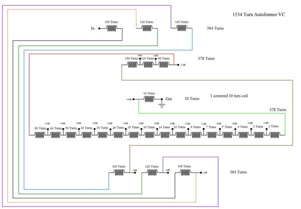

You really don't want to wind an autoformer in a straight linear manner. The capacitance will kill the high frequencies. It needs to be interleaved and balanced. I don't have an example on this current computer. However, later today I will try to post a picture of what I'm talking about.

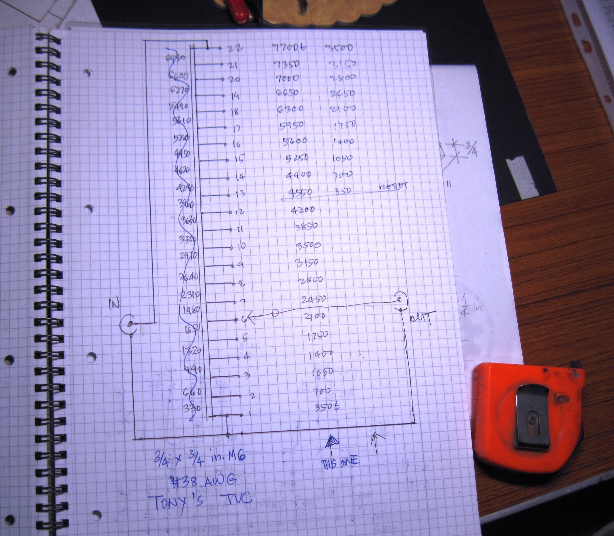

if you can get someone to wind this for you...
this is Tony's TVC, core is EI 3/4 inch,
magnet wire is #38 awg on a 3/4 x 3/4 inch bobbin..
22 position rotary switch to select taps..

i am using a dual bay bobbin to cut capacitance in half...
Using a dual bobbin does reduce capacitance. However, it doesn't distribute the capacitance evenly. If you interleave the autoformer windings and balance them like in the attached diagram you will have consistent high frequency behavior at every tap.
Can some one tell me the logic to compute the turns required for each tap? Any formula for this?

tbh, i never built this as my hand can not handle the wire size and several attempts i made ended up in failure, i asked my friends to make one for themselves and they liked it...if you can work on such small wires, then go ahead..
yes two bay bobbins ca be used...
M6 cores worked best here...
