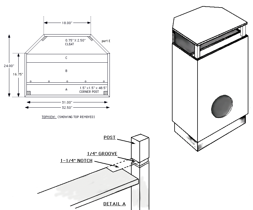

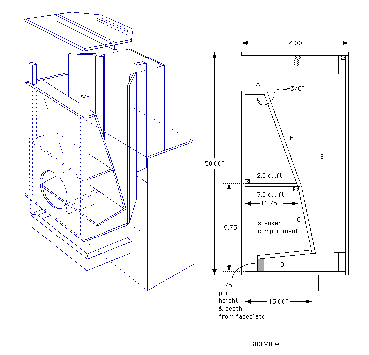

The 15" coaxial is kind of big to be placing on the small end of a long folded horn so perhaps one of the classic rear loading corner horn cabinets from the Golden Age might be a good idea. Remember the Jensen Imperial and units like that? I'm not specifically sure about the Imperial being the type of cabinet I am trying to refer to but some searching ought to find some good classic designs.
now thats an idea that i might take up 😀 those folded horns look bit complex, but i am willing to give them a try. my mates dad cut the wood for my basshorns so ill get him to cut the wood for these 😀
the imperial design you talking about, is that on the decware forums?? that be too big for my room 😛
i think ill make an 's' bin unless there is a better rear loaded design. im doing some study now on this 😀
There's two Imperials - the build in which is pictired and Decware sell the plans for, and the corner unit which is similar in size to a Khorn. The latter would be better for the Selenium 15CX imoplanet10 said:

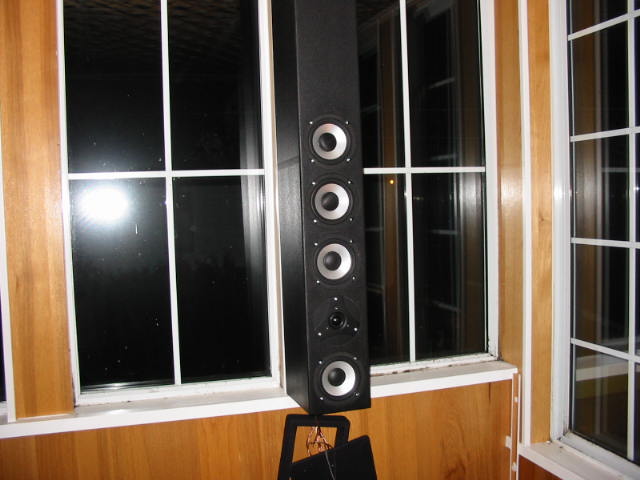

This is why I have to put them in the ceiling. With the new TV and entertainment centre along the end wall there won't be any room, so they are going in the ceiling in the panels just on the inside of the left and right channels of the HT units you see mounted between the windows.
Those things under the left and right speakers and above the center unit are the crossovers. I will post pics once the system is complete and the room is cleaned up a little.
Can't wait for the coax's to arrive.
Cal
Cal
Cal Weldon said:Here's a shot of the right channel.
Are those the MCM Al 5"?
I always liked the MTM-MM 2.5 way idea.
dave
