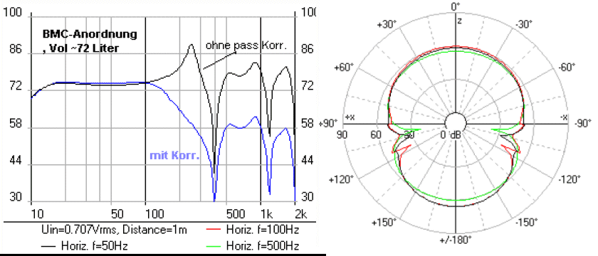

The picture shows a simulation of a 16” driver in a BMC ripole. Measurements of another driver in the next post will show, that SPL below 50 Hz is too optimistic, but otherwise the simulation seems to be quite correct. I include this picture because it’s the only polar diagram of a BMC ripole I know of. The dipole 8 is somewhat compromised. SPL in the polar plot is the same as in the left diagram (not as shown on the diagrams x-axis). So attenuation is ~12dB at 90°-120°.

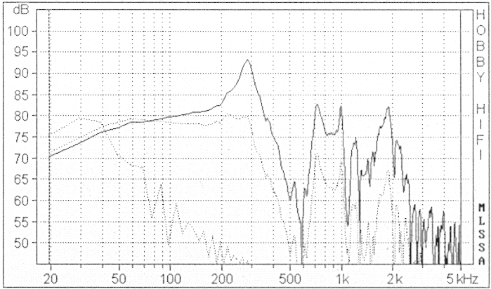

Ripoles - Honey, I shrunk the dipoles! #3
This is the measurement of a Vifa 30 WN 380 RL/8 woofer in a N ripole. Mic distance 1m. Black line is without any compensation, dotted line is with a zobel/notch compensation I will explain in the next post. Dotted line at the left is for some active x-over which I don´t discuss here.
Note that with the compensation SPL is flat from ~300Hz to 50 Hz. If you are lucky room gain will take care from there on. So you don´t need any special equalisation.
The cabinet for this ripole is 9” wide, 16” high and 14.5” deep.

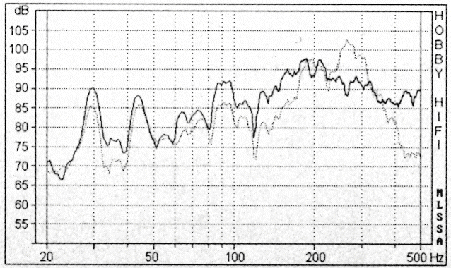

Last diagram is a comparison between a U dipole (Kreskovskys NaO-Woofer, black line) and a ripole (dotted line). These are in room measurements with a mic distance of 4.5m from the dipoles. So room resonances are dominant. There is no compensation or equalisation. While most people would prefer the black line - two considerations:
(1) The ripole roll off below 130 Hz seems to be less steep than the U frame roll off. So it should be easier to equalise.
(2) The volume of the ripole is half the volume of the U frame!
Drivers are identical (GBS-512/4 with a less than perfect Qts of 0,56).

Post 2 - the simulation of a 16” driver in a BMC ripole:
- When these are not boxes, do you know why they refer to 72 litres – is that notional volume of the exterior measurements?
- In the left graph, what are the blue and black curves?

Post 2 - Most likely, and it seems that the blue line is the response with crossover.

I can´t tell whether those 72 l are interior or exterior. There are no dimensions of the ripole given.
The black line is without correction, the blue line with a passive correction filter. This filter would be more complex than the one described above.

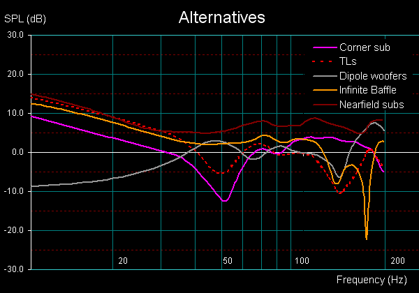

Room gain - I haven't seen actual measurements which indicate either way, but you can simulate the room response of a dipole (showing only the impact of the room), and those sims that I have done show that room gain isn't happening.
Attached file shows a comparison of the room response different subwoofer options in my listening room (4 x 5m x 3m ceiling).
Note how where there is room gain for the monopoles, the dipole has an inverse gain ie a loss over and above the dipole rolloff.
Perhaps someone can give a theoretical reason for this, or conversely a challenge to the validity of the sims. They were done with the FRDC Room Reflection Calculator.

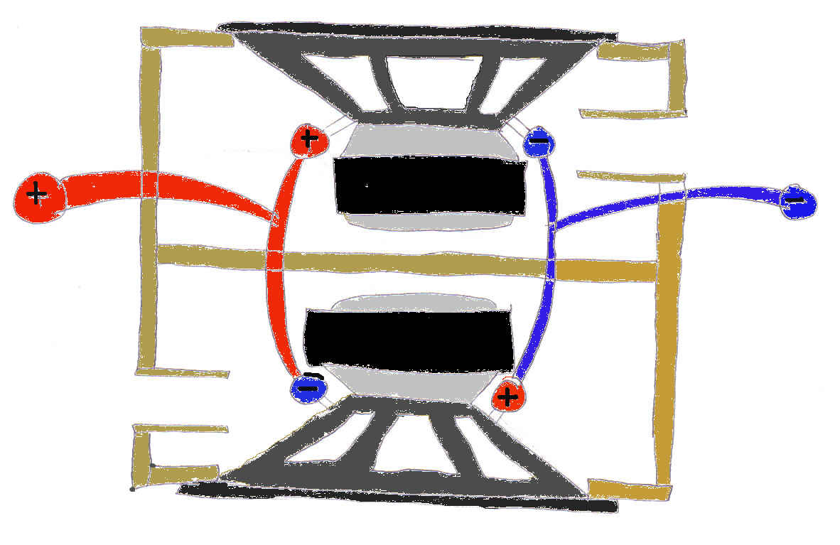

Rudulf,
The photos of Axel and his ripoles seem to show the unit not as 2 N cabinets but a reduced W. What I mean is that both woofers look like they fire into one another with no panel between them. I believe that it also looks like the air space between the woofers is curved at the back so that a half-circle is formed. Does this describe the model that you have tried?
Thanks, Randy

Re: Configuration
Randy,
thats correct. They ARE reduced W-baffles, but with a minimized air volume in front and back of the woofers.
I see that in the picture the cabinets look as if they are curved at the back, but they are just square. No half-circle in it.
Rudolf
