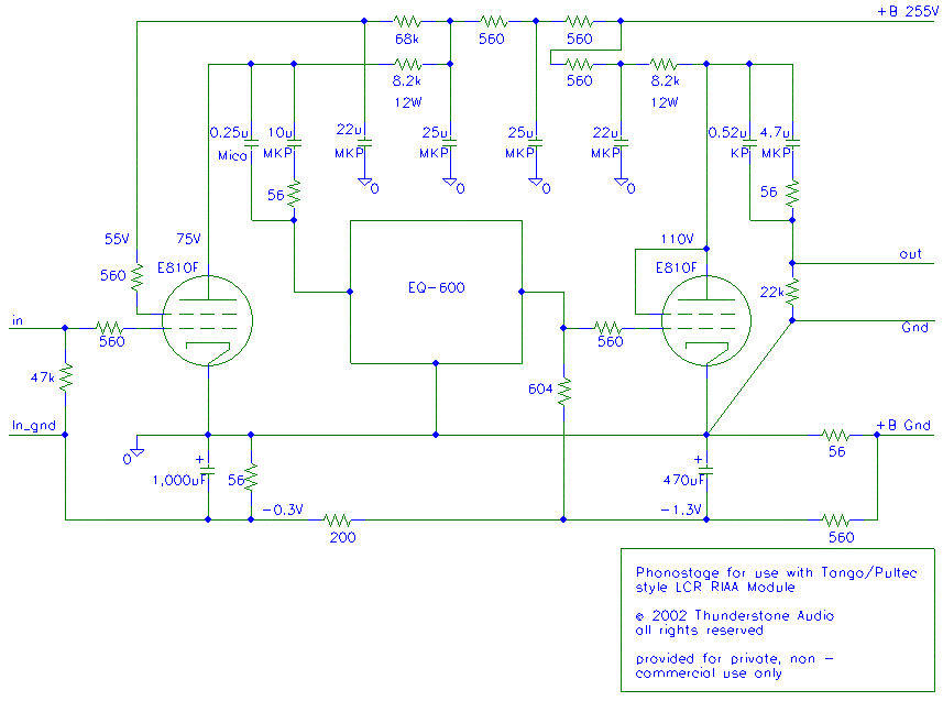

Konnichiwa,
I noticed in several cases that despite previous notes and the application notes on the S&B Website for the LCR people struggle to work out what can be done and what not. So, I'll try to cover here the principles.
Please note that said principles apply equally to the 600 Ohm RIAA Modules, the S&B 600R and 10K RIAA Modules use EXACTLY the same Circuit, merely the component values have been adjusted to give the desired impedance.
The first thing to understand is that these networks are constant impedance T-Networks. In other words, they operate in a constant impedance envoironment and themselves present a constant impedance load at their nominal impedance (600R/10K).
This means in a "classical" situation the RIAA would be terminated with it's nominal impedance on either side, in other words the source impedance of the receeding stage would be made equal to the RIAA Modules and the RIAA Module would be loaded with it's nominal impedance.
In practice one of the terminations can be omitted, but NOT both. This means you either operate the RIAA Module with a near infinite load impedance and from a source impedance equal to it's nominal impedance.
OR you load the RIAA with it's nominal impedance and then you are free to select the source impedance with impunity.
In fact, I used this feature in my E810F/D3a Phonostage with the 600R RIAA Module shown here:
Here I use a Penthode stage which hase around 8KOhm output impedance and a gain of around 50db. This stage is then loaded with the 600 Ohm RIAA which results in a loss of gain of 23db brining the gain into the RIAA down to around 27db.
The bottom line, you need either a load or source that is equal to the nominal impedance of the RIAA within a few %. In any case, the stage driving the RIAA Module will be loaded by an impedance equal to the RIAA Modules Impedance, plus the effect of the Anode load, which appears in parallel with the RIAA Module.
The easiest way to GUARANTEE that the RIAA performs accuratly with total disregard to valve aging is to load the RIAA Module with it's nominal impedance and to insert a coupling capacitor of suitable value in front of the RIAA Module. The minimum capacitor that works with a 10K RIAA Module is around 2.2uF and for the 600R RIAA it is 39uF.
The next thing is to have a first stage in the Phonostage that is able to drive the load of the RIAA Module without massive distortion and at the levels required plus it is required to stiull develop usefull gain into the load presented by the RIAA Module.
While it may be tempting to use an ECC83 as first stage, this stage would show an output impedance in the region of 50KOhm or more and would distort heavily into a 10K load.
Therefore we need a Valve with low anode impedance and reasonably high gain. Among the common small signal valves the ECC88/6DJ8/6922 will answer the purpose reasonably.
Better choices will be valves with more gain and higher transconductanace such as the WE 417A, WE 437A, russian 6S45PE, 6S4P, 6S3P or triode wired high transconductance pentodes such as the E180F/6688/6Z9P, C3g or E810F/7788 and D3a/7721. Some of these may even be used directly to drive the 600R RIAA Module.
For our example however I will stick to the 6DJ8 and the 10K RIAA as it is readily available and known. The calculation of the other examples shall be left to the genteele reader as an excercise in applied math.

The circuit would look like this:

Thorsten,
THANKS for the detailed explanation.
I recall seeing some "chatter" to the effect that the 600 Ohm RIAA module is superior to the 10 KOhm version. Is the "chatter" correct?
I've been mulling over a 6DS4 loaded by a Gary Pimm CCS as the 1st gain block of a phono stage for some time. The impedance of the CCS' mu follower O/P is a few hundred Ohms. Am I correct in thinking that the 600 Ohm RIAA module will be fine driven by the CCS' mu follower O/P, so long as the grid leak resistor of the 2nd gain block is 604 Ohms?
If my thinking is reasonable, could you make a recommendation for the coupling cap. that goes between the CCS' O/P and the RIAA network?
TIA for a response.

Konnichiwa,
I have not had a chance to compare, the 10K RIAA's are in sort supply and I have come up short again and again (well, lack of time let me tell JB "okay, send them off elsewhere")...
Assuming the Mu-Follower operates at sufficient current to sustain the neccesary output voltage into 600 Ohm - Yes.
You will need a VERY large value capacitor. If you accept -3db @ 20Hz (which I do not) you need around 12 - 15uF, for a -3db point of 4Hz (which I aim for) you need 68uF.
You COULD use another trick.
The Mu-Follower output of your circuit has a low and fairly well defined impedance. The S&B Riaa contain Capacitors with 630V or more DC rating in all shunt path, so it will withstand quite a bit of DC offset, as long as no DC current flows.
Therefore, if your source can be made to have 600 Ohm net impedance you can couple the S&B RIAA (and ONLY the S&B one) directly and place the coupling cap AFTER the 600R RIAA, making it's value uncritical.
Sayonara

May I ask what kind of musical information you're hoping to find on a record at 4 to 20 Hz?
Information that, if at all present, will be filtered out by the RIAA correction anyway.
To the best of my knowledge the only thing to be found in that frequency range are subsonic resonances stemming from cartridge/tonearm interaction.
Amplifying those will only give you a false sense of bass response much the same way speaker cabinet resonances appear to be part of the music to some (most actually) people...........
EDIT: There should be no reason whatsoever for a 600 Ohm LCR
RIAA filter to be "better" than a 10K one provided both are properly designed and implemented.
Cheers, 😉

I'm mostly with Frank
Trying to get too much low frequency response from a RIAA preamp is asking for trouble.
The RIAA Spec is:
75us low pass (2122Hz)
318us high pass (500Hz)
3180us low pass (50Hz)
This spec. was later modified by IEC to add a 10ms High Pass (16Hz).
The problem with the straight RIAA spec. is turntable rumble at approx 0.5Hz (33 r.p.m.) together with the 3180us (50Hz) low pass. This means response is increasing (at 20 dB/decade) below 50Hz. The response at 0.5Hz can therefore be +40dB above the 50Hz response. Even if your power amp /speaker etc can't reproduce the low frequencies you run the risk of saturating the preamp active stage(s).
IEC added the extra pole at 16Hz to make sure response was well down at turntable rumble frequencies.
My own experience was that I couldn't tell any difference with this extra pole anywhere between the recommended 16 Hz and an experimental version built with this extra pole at 32 Hz instead of 16Hz - I left it at 32Hz.
Of course this experience was with a solid state phono preamp with a mix of active and passive compensation and the LCR MAY not exibit this problem.
It is something to be extremely wary of when designing phono stages.
This is a nice simple way of dealing with the coupling issue that I hadn't thought of.
With the standing current high enough to handle driving the 600 ohm module the output impedance is going to be too low to use the MU output directly. The way it could work is to include a series terminating resistor between the MU output and the input of the S&B module. The value of the resistor would be selected to make the total impedance of the MU output + resistor = 600 ohms.
There are 2 ways to get the standing current of the stage up to the level needed to drive the 600 ohm input cleanly. One is to run the triode with the total current desired. The other is to add a resistor (or CCS) to ground from the MU output. The second variation gives the ability to choose the triode current independantly of the total stage current.
Another feature of using the CCS as a load is you will get full mu of the triode without having to bypass the cathode resistor. One less cap in the circuit is always a good thing in my book.
This coupling scheme could work nicely if you are not adverse to the series terminating resistor.
Gary
Gary,
Thanks for the feedback.
The 6DS4 nuvistor is a low current type. So, a secondary current sink is the route to follow. The 6DS4 runs at a voltage somewhat less than that used for the 6922. Finding a suitable N channel FET for the secondary sink shouldn't be too difficult.
Michael Percy carries 1 KOhm Vishay 1280G trim pots. With their bulk metal foil construction, the Vishay parts seem to be the right choice for dialing the 600 Ohm impedance in. An adverse sonic impact should not be observed.
FWIW, I'm thinking of using the same red LED for bias that is used in the Bottlehead Seduction.
