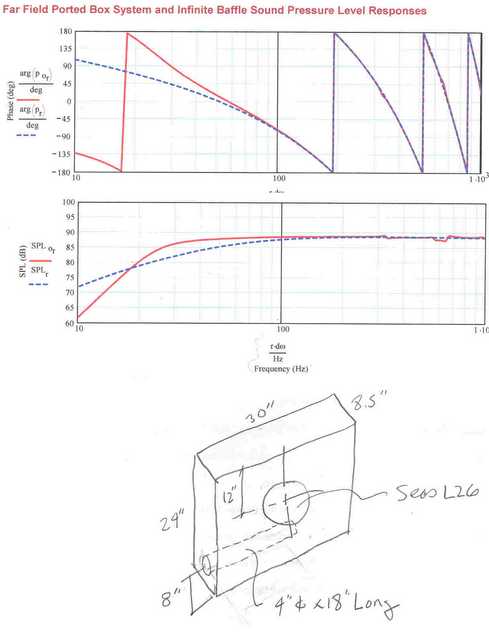

Interesting simulation on the L26. However, you simulated a ported sub, but on the Cain&Cain website I find some text telling me that the Bailey is a sealed sub, on the other hand the images show some kind of port ...?
I'm fairly new at this, but as far as I understand a closed sub is preferred when one is looking for a tight and 'fast' sub. Is this a general truth or can a ported sub be 'fast' and musical (transient response?)? Most commercial high quality subs I've seen are sealed. I'm aware of the drawbacks in building sealed subs, like having to use low end EQ and high power requirements.
Have you ever considered using some of the popular high x-max drivers out there like the XLS, TC2+, AV12 ..? I understand the AE (Stryke) AV12 is in high regard but may be difficult to purchase right now. I have not modelled these drivers yet but I get the felling that they are capable of far more than I really need ... I have no experience myself building subs so I'm having a hard time figuring out exaktly what I need in terms of sound pressure and other specs. I listen to a mix of music ranging from such artists as Metallica to Diana Krall ...

I looked again at the Cain and Cain site and it sure looks like a ported sub. The dimensions appear to be similar to what I modeled, if you compare the driver to the sides, depth and length. Although I agree, that a sealed sub is mentioned in the write up.
I don't have a lot of experience with subs, but still feel that SeasL26 has a lot of promise for the reasons cited by Cain and Cain. I will have to do some more investigation to see where this takes me. Probably the best way to resolve this is to pick up the driver and build some test boxes to see which I like better - sealed or vented. I should be able to report back in a month or so.
