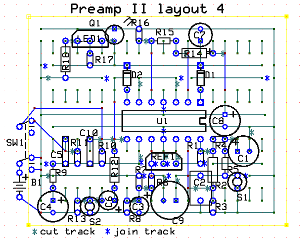

Sounds like a good plan to me 🙂 I made preamp II and one thing I'm a little concerned about is the size of the caps on your pcb layout, quite a few look too small to me.
Attached is my layout (on experimenter board) with the actual cap sizes (these were the smallest ones I was able to source in panasonic FC series, and rubicon ZA. Note especially C9 (don't remember what brand that was, but there is quite limited choice in NP's here in Aus).
One other thing that I'd think was possibly worthwhile, is a modifiction to the circuit to have a gain of more than 20 (if that is possible)..... after testing on the weekend, it would have been nice to have a bit more gain when doing the 1M on axis tests, rather than cranking the volume on the amp up so high (was wearing earplugs, but not sure what the neighbors thought) 🙂

The electrolytic capacitors were spec'd as Panasonic FC caps, and C9 is to be a Panasonic SU 16v 10uF cap. The datasheet says 5mm diameter, 11mm height, as with the majority of the other caps on the board. (only larger caps are the 100uF 16v FC caps with a 6.3mm diameter).
For the 5pf cap, Mica seems to be the only cap that I can find of that value from Digikey, which is not surface mount. They are quite expensive in that value, so I am looking for an alternate part, any suggestions?
I am still finalizing the selection of parts, and will do a digikey order of the parts to verify the sizes on the layout before ordering the prototype pcb.
For this project, all parts will be available from Digikey, except for the RCAs, which I sourced from Vampire Wire (sound connections) from a previous project.
Brian

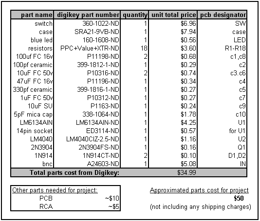

Here is a preliminary digikey parts list for this project:
This assumes that Vikash and I would only be selling the PCBs and RCAs, and the rest of the ordering would be done by the builder through Digikey (or similar vendor).
I am going to order all the parts and do a test fit on paper, and then if it looks good, I will get some prototype pcbs done, and if it works, then I will order some production pcbs (probably red 🙂). I only started this project on Saturday (2 days ago), and I don't expect to have any production boards made for at last a couple of weeks.
