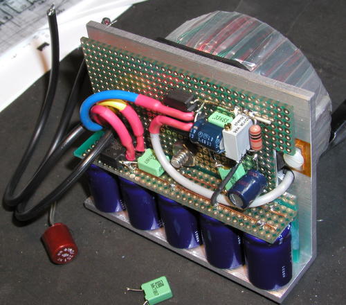

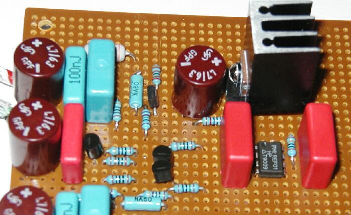

Fet regulator circuit
Mosfet and Jfet +15 volt regulator. 2SK170 diffamp with 3mA 2SK170 CCS drain load. ZVP3310 mosfet follower drives IRF510 mosfet follower output. PMI REF01 10 volt voltage reference with RC input and output filters. WIMA and RIFA polypropylene and Seimens Electrolytic caps. Two +15 regulators will be tied together at outputs for +/- 15 outputs. Inputs are seperate 25V CLC filtered supplies with snubbered soft recovery diodes.

I don't think so........ Actually I will use it for preamp circuit I am designing. Designing reglators is as fun as audio circuits and is probably as important to the sound. If it sounds OK I will post schematic if anyone is interested.

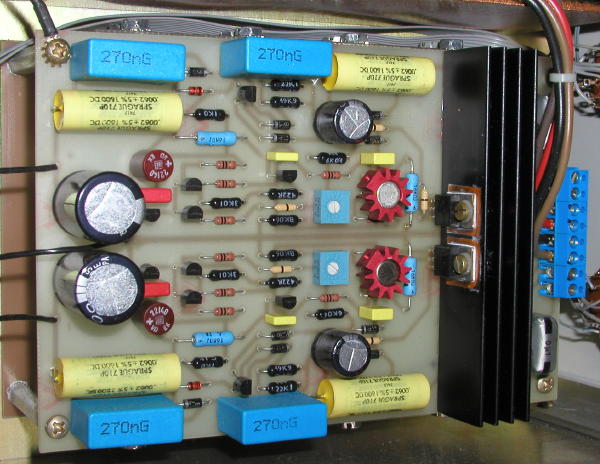

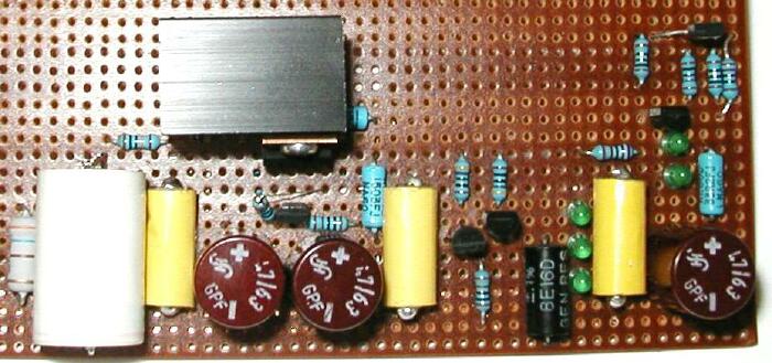

Fet regulator circuit version 2
Changes from first version:
LED voltage refences biased by jfet current source fet, 10K resistor to ground for drain load for jfet diff amp, mosfet current source for bias for 10K resistor and jfet drain current, F-Dyne polypropylene and foil 0.1 uF caps, 1Meg and 3uF filter for voltage ref, copper foil tape ground trace and better layout in terms of decoupling and gound current return paths.

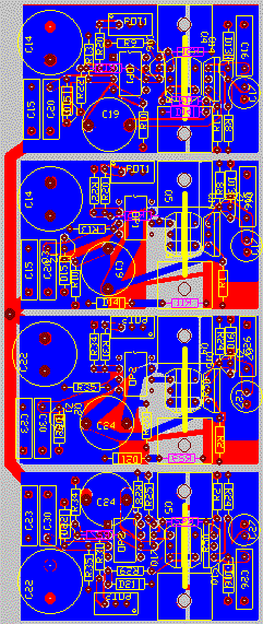

Here is the power supply (shown withou pre-regulation) for my next Pearl. I own the layout but not the design, so I cannot share unfortunately. This is going into some commercial equipment 🙂 but I am of course free to use it myself.
Topology: +-HV (up to 90V) and +-LV (set up for less than 30V).
The reason the two are different is amongst other things the inclusion of op-amp power from source on the HV version.
Design optimized for short sense resistances to op-amp and extremely short signal path from output of op-amp.
Petter

Peter great job as usual. You are the Martha Stewart of DIY. Want to give us a basic overveiw of design? Looks too simple for a convoluted Madrigal design. What are the blue caps, ERO or Rifa. I will work on posting schematic next week.
