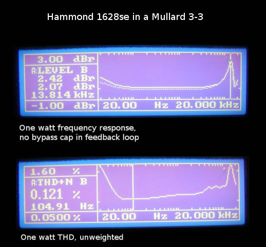

Measurement-wise the TX problem - in my amp - manifests itself as a short, quick 2 dB rise at 13 kHz under rather large amounts of purely resistive feedback, significant ringing on square waves and rapidly rising distortion with frequency. Ironically I spent the night before Sherman's post on the bench tuning the feedback capacitor trying to minimize just these issues. The best I could achieve was dead flat response to 14 kHz, a 1 - 1.5 db downward knee to 16 kHz, relatively flat to ~ 18 kHz, followed by a rapid rolloff (~ -3 dB @ 20 kHz) and then an ultrasonic rise in the 40-50 kHz range. A very odd frequency response. It wasn't possible to eliminate a large spike on the rising edge of square waves or the rising distortion with frequency. This is at 1 watt output.
The problem is suprisingly audible as a 'dirty' high end, to my ear similar to speakers with high freuqency issues, for example the Tang Band W4-657s with its very narrrow 4-6 dB rise centred at 8 kHz. It's not as obvious but very similar in character. Carefully tuning the feedback cap reduces it significantly but the highs never really sound clean and extended. Cymbals suffer the most.
Check the SAC Thailand test results. That's nasty stuff.

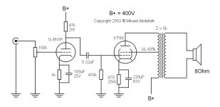

Johnny,
It is a single-ended KT88 amp. The schematic was posted here by Mikael Abdellah. I don't think he would mind my posting it here. He built his amp as an integrated stereo. I am planning on doing mine as monoblocs.
Hi Sherman, I think you'll be much happier avoiding the 1628se in this application. If my reaction to Hammond seems a bit extreme, the PS transformer from them was also bad in every way - voltages 10% over, mismatched isolation washers, screws of different types cut to length with side cutters (!) and a finish which flaked off with a thumbnail. Neccessity drove me to strip and repaint the TX housings on my amp, not aesthetics. I've worked with Hammond product, mostly line-level and PS transformers but racks as well, for almost 25 years and never saw anything this shoddy.
Attached is a jpg of the measured results with the 1628se. The FR is resistive feedback only. That rising distortion with frequency response is audible, most bandwidth limited gear I've measure in the past shows falling distortion with increased frequency, as would be expected since the depressed high frequencies of the device under test is suppressing harmonics.
