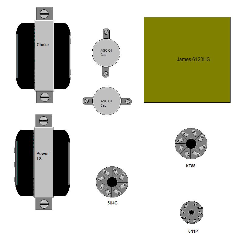

Now I'm putting all the dimensions into TurboCad to try and make a life-size drilling template. That way it would be easy to flip so I can make the monoblocs mirror images.

I'll decide when the Hammonds arrive and I place everything on the top plate to get a visual idea. Attached is my current layout idea. The top plate is 12" x 12". All connectors will be on the "back", the side closest to the choke and OPT. I plan on making them mirror images of each other.

planet10 said:

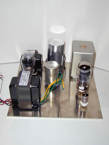

Shouldn't the choke & trafo be 90 degrees to one another?
dave
Yeah, technically they should and I might do it that way. I've been trying to come up with a layout that makes sense and fits the size I have in mind. I took some ideas from Derek Walton's layout. ( http://indigo.ie/~walton/300bdrawings.html ) He says he tried the choke both ways and found no difference at all.
I think though that I may put the choke in back even though it is smaller and may look a little unbalanced. It makes the wiring much more direct and allows the AC and DC to be kept completely separate and not cross as they do in Derek's layout.
Here is a shot of the potential layout with the actual pieces.

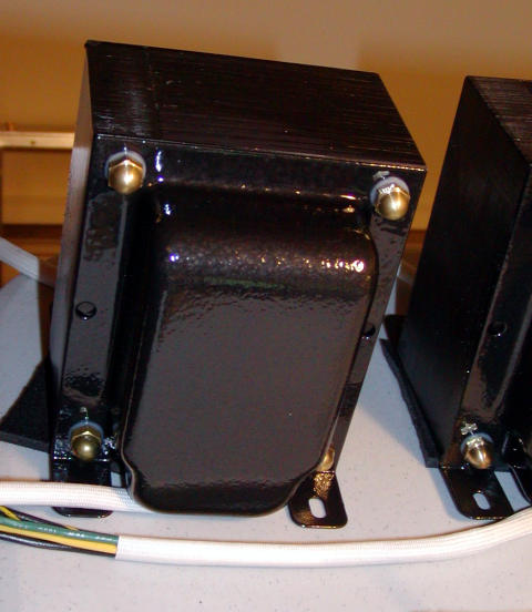

I have a question regarding painting the Hammonds. Can I paint the laminations or only the bell ends? I was thinking I would use masking tape over the openings where the wires come out and just paint the entire transformer. I found that Rustoleum Special Appliance Epoxy spray paint in "Stainless Steel" is a very close match for the James color, probably as good as I'll get without having a color custom mixed.
BTW I measured the voltage from the Hammonds. I get 802 volts on the HV, 5.72 on the 5V heater leads and 7.28 on the 6.3 volt heater leads. The HV is supposed to be 700 volts (350-0-350). I don't think I blame Hammond for the over voltage though as my AC is consistently at 124V rather than 115!
That's what I did, remove the end bells, paint and bake them separately, mask and spray the laminations. The PS tranny gets hot enough in normal use you'll smell paint curing for a couple of weeks anyway, the laminations still get a baked finish. The result on a 1628se is shown below. The paint's a Rustoleum Hammered Metal. Generic hardware store stuff, as were the nuts and plastic washers.
BTW, I agree with Dave about the excess HV voltage. It allowed an extra stage of RC and the result is surprisingly quiet for such a simple circuit. Now the excess filament voltage, that I'm not happy about but for now am content to drop it with a couple of .21 ohm, 100 uH iron core hash coils from the junk box. A little free filament filtering, looked at from the sunny side.

rdf said:
That's what I did, remove the end bells, paint and bake them separately, mask and spray the laminations... The result on a 1628se is shown below. The paint's a Rustoleum Hammered Metal. Generic hardware store stuff, as were the nuts and plastic washers...
Great, I think I'll paint them this weekend! Time to run out for some acorn nuts and threaded rod. I found a spray paint (also from Rustoleum) called Special Appliance Epoxy in a color called Stainless Steel that is a pretty close match for the color of the James.
I'll have to experiment a little with a load on the PS to see what the filament voltage really is. If necessary I'll follow your lead and put in a couple coils to get it down to the right range.
