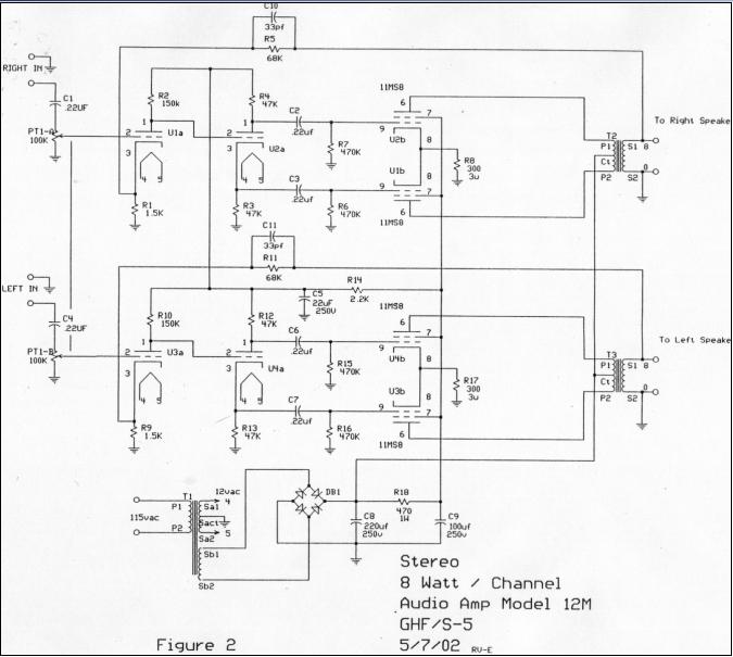

K-12M Schematic
The schematic for RV-D (10/5/01) can be found at:
http://lib1.store.vip.sc5.yahoo.com/lib/webtronics/km12sch.jpg
I have scanned RV-E (5/7/02) and attached it below.
The only difference I see between RV-D and RV-E is the addition of C10 and C11, which are 33pf ceramic capacitors.
Gio.

Yep, so don't touch them! What I meant before was, whether you were able to touch the transformer, not the valves.
They may be necessary if your source has enough DC on its outputs to mess up the operating point of the input valve, and since this is DC coupled to the phase splitter (Williamson-style) you might mess things up there too. That's why they were put there in the first place. Make sure there is no DC on the outputs of your CDP or pre or whatever before you remove the input caps.
A single fast diode is enough as shown on the Voltsecond site, but I suppose you could change them all.
This is triode-strapping the output valves. So, it means less power from the amp and more drive is needed to the output valves. Open-loop distortion will also be lowered.
You may end up with any of excessive gain, compromised frequency response, or higher output impedance. I wouldn't do this unless you triode-strap the output stage, which in itself will reduce gain and decrease output impedance.

series caps on the input are there to block incoming DC from the previous stage, which is very unlikely to be there in any significant amount. they will degrade the sonics without a doubt. in fact they are rarely seen even on seriously fancy-dan amps...
it is possibly to somewhat decouple diode noise from the PS with a single series diode but i prefer to eliminate it altogether by making a bridge with four freds...or better yet install tube rectification...
re: the NFB, don't remove it unless you do the triode strapping first.
the combo of those two will decrease output power and increase overall gain (fact), and drastically inprove the sonics (imho).
you will lose 3 db at the speaker before distortion but gain a great sonic improvement, and possibly avoid eviction 🙂
gmilitano said:
Hi Blackie,
Why are the input caps not required?
The diode is a single bridge. I was considering the UF4007 mod as proposed Voltsecond.
What would be the purpose of removing the negative feedback resistor?
I will post the new schematic.
Gio.
Re: Re: Re: mods.
I conversed with VoltSecond via email and apparantly there are some new mods in the works. I did not get any details, but he is trying out some larger PS filtering caps.
Blackie,
Before I get rid of the coupling caps completely, I want to try out some film and foil caps to see if that makes any noticeable improvements.
Also, the VoltSecond site does a good job in arguing that only one diode is needed. Tube rectification would be ideal, but likely a little to advanced for me right now and this is only a $139 amp! 🙂
I was skeptical that a $139 tube amp would sound much better than a typical SS amp. However, I am shocked with how much of an improvement this tube amp is over my various mass market SS amps.
I'm glad to say I am a convert!
Happy New Year,
Gio.
Blackie,
Happy New Year,
Gio.
Re: Re: Re: Re: mods.
happy new year gio!
i did see the voltsecond mods...but my suggestion was made with this in mind: rather than reduce diode noise somewhat by adding a mess of cheap parts, better to eliminate it altogether with fewer parts.
the cost difference ain't that much!
but hey, i just saw diodes and snubbers in a $4500 Cary 300B amp! 🙁
gmilitano said:Blackie,
Happy New Year,
Gio.
happy new year gio!
Re: Re: Re: Re: Re: mods.
With regards to the input coupling capacitors, what would be the source of DC that they would need to block?
Also, what did you have in mind regtification for the power supply.
Gio.
Gio.
Re: Re: Re: Re: Re: Re: mods.
it is possible that there might be a small dc offset originatingin the output stage of a cd player or preamp caused by poor design or failure due to poor design.
if that were so, you would hear it when you rotate the input pot as "scratchiness".
pretty unlikely. if you look at the input stage of most tube amp designs, you will find no caps.
you can get these to replace the diodes:
http://www.digikey.com/scripts/dksearch/dksus.dll?Detail?Ref=158606&Row=255948&Site=US
they make no diode noise. fast recovery epitaxial diodes.
Gio.
Re: Re: Re: Re: Re: Re: Re: mods.
Ok. How could I go about checking if there is DC from the source? Would a voltmeter on the CD outputs do the trick?
Will the only result be "scratchiness" when changing the volume or will the lack of caps affect the overall sound quality if DC is present?
Are those diodes much better than the UF4007?
Gio.
Gio.
dc offset and freds
you can measure dc offset with your voltmeter.
its presence would cause a shift in operating point of the first 2 gain stages of the amp (they a direct coupled) proportional to the amount of dc.
the freds are better (i.e. less noisy) than uf series diodes, and they only cost $1.08 each. they have virtually no switching noise.
cheap insurance as they say...
search digi-key, part number DSEI8-06A-ND.
