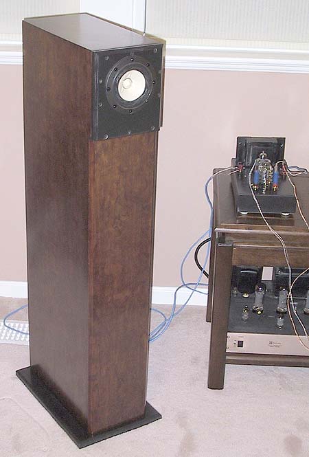

coredump said:
I have completed a FE108EZ-based Buschhorn
My buddy Chris put FE108eSig in his BHorns ... very nice, but lacking in bass... tweaking amps seems to be helping there thou...
dave
Dave,
my 'listening room' is quite small, with a wooden, suspended floor and quite a few room modes. My biggest concern was boominess, which is best triggered in this room via (reflex) ported speakers; but the horns produce excellent, tuneful bass here.
I guess I'm hooked. :)
Huge bass improvements were definitely achieved by implementing an impedance trap (0.56uF Solen+8R2 MOX parallel to the driver) and two pieces of a broomstick (glued into the horn mouth between the side walls). The bass wasn't any deeper afterwards, but much better defined. A lot of 'reverb' effects went, too.
Best regards,
Oliver

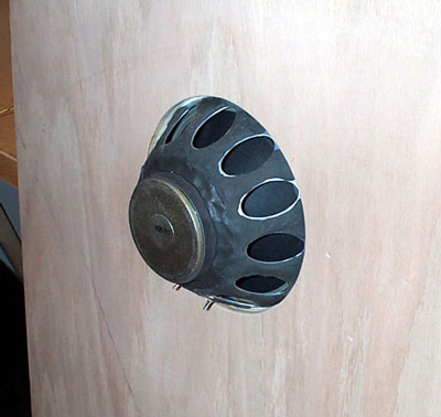

well sir, i just cut up several billion pieces of damping sheet and stuck 'em on my driver frame in several billion places.
i am totally underwhelmed by the results. i could tune me guitar to the pitch this fe166 basket makes when i tap it with a chopstick.
a lovely CLANK that increases in amplitude on the ears of the frame.
ima mortite the hell outta this one and mount it.
i'm trying ductseal on the next one. sheesh.
iuno, this damping sheet kicks **** on a panel but had barely any effect on this basket.
