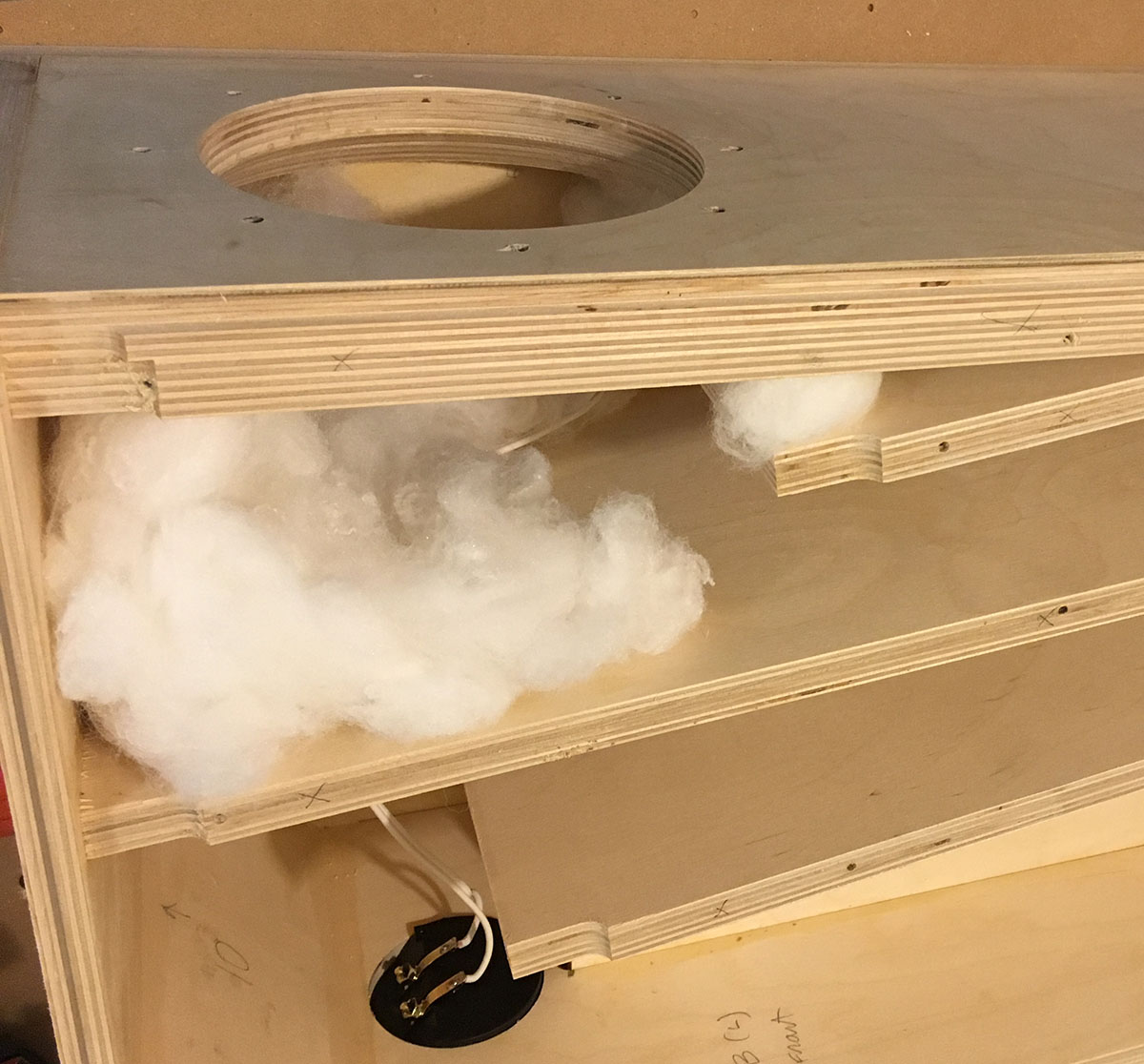

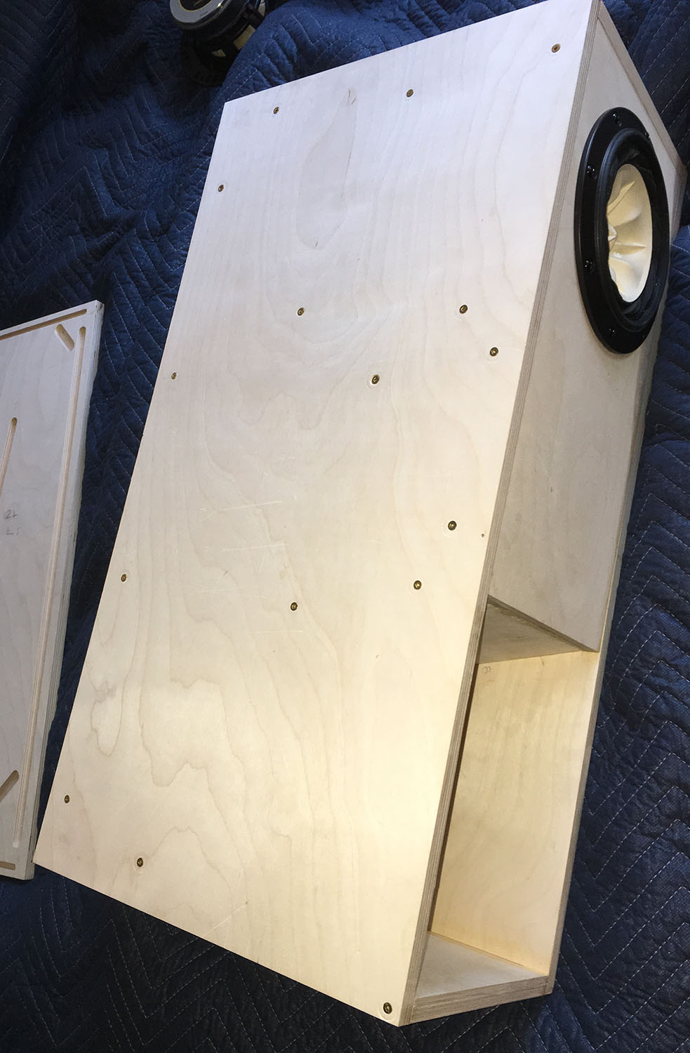

I like the idea of gluing one side together for experimenting before final glueing. Screws used?
Not by themselves unless you want chronic leak-paths. With some sealing tape, maybe. Alternatively, get a few packets of Blu-tak or whatever your equivalent thereof may be, roll into long continuous strips (no spaces of any kind: it has to be air-tight) and use that to temporarily fix one side panel in place. You'll actually have a merry dance getting that side panel off as it sticks the thing on quite firmly.
For temporary sealing of side panels during prototyping / fine tuning of damping/bracing, I've always used a combination of thin closed cell glazing gasket tape and screws. Some guys like to use clamps, but I suspect that their extra mass would effect the enclousure's resonance characteristics, which is one of the things this part of the process is attempting to resolve.
Of course I have no objective measurements to confirm that, and to reiterate one of recent favourite forum quotes -" DIY is all about denial" - in this case that such intuition can't be wrong
I assume that after you are happy with the tuning you glue the final side panel on. At that point do you omit the screws and use filler for the holes? I've heard some people like an all-glued final assembly for uniformity in tension of panels I guess.
Also, I will probably go with no dampening fabric on walls- just the Acoustastuff behind the driver- and just go ahead and glue the final side panel on today. But I'm plagued with another question- I'm thinking of putting sand in the lower rear void at the rear bottom of the BK-16. This would be non-reversable. Any opinions thoughts? This is recommended in a lot of the Japanese Nogoaka folded horn DIY instructions.
Yes, once I'm happy enough with the damping fiber, I'll glue up - using the screws again as clamps, then remove and fill with bondo before veneering. If it's a prototype for something that will be run in any kind of volume., I'll note the weight and distribution of fill, and can avoid that step on future builds.

Think I will assemble with wood screws- I have some nice 1" #6 brass square drive wood screws.

Careful with square drive brass screws - it's far easier to snap the heads off than you might think - particularly as small as #6.

I was smart enough to do some trial runs on scrap wood- did break off one of the heads. So I know about how much torque it will take. Wish I could find a good countersink adjustable tapered drill with decent stop for doing these. The Rockler one I have didn't work out so good- kept getting different countersink depths- and marks on the work piece from the stopper. Stopper difficult to adjust.

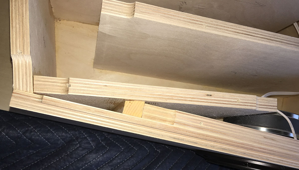

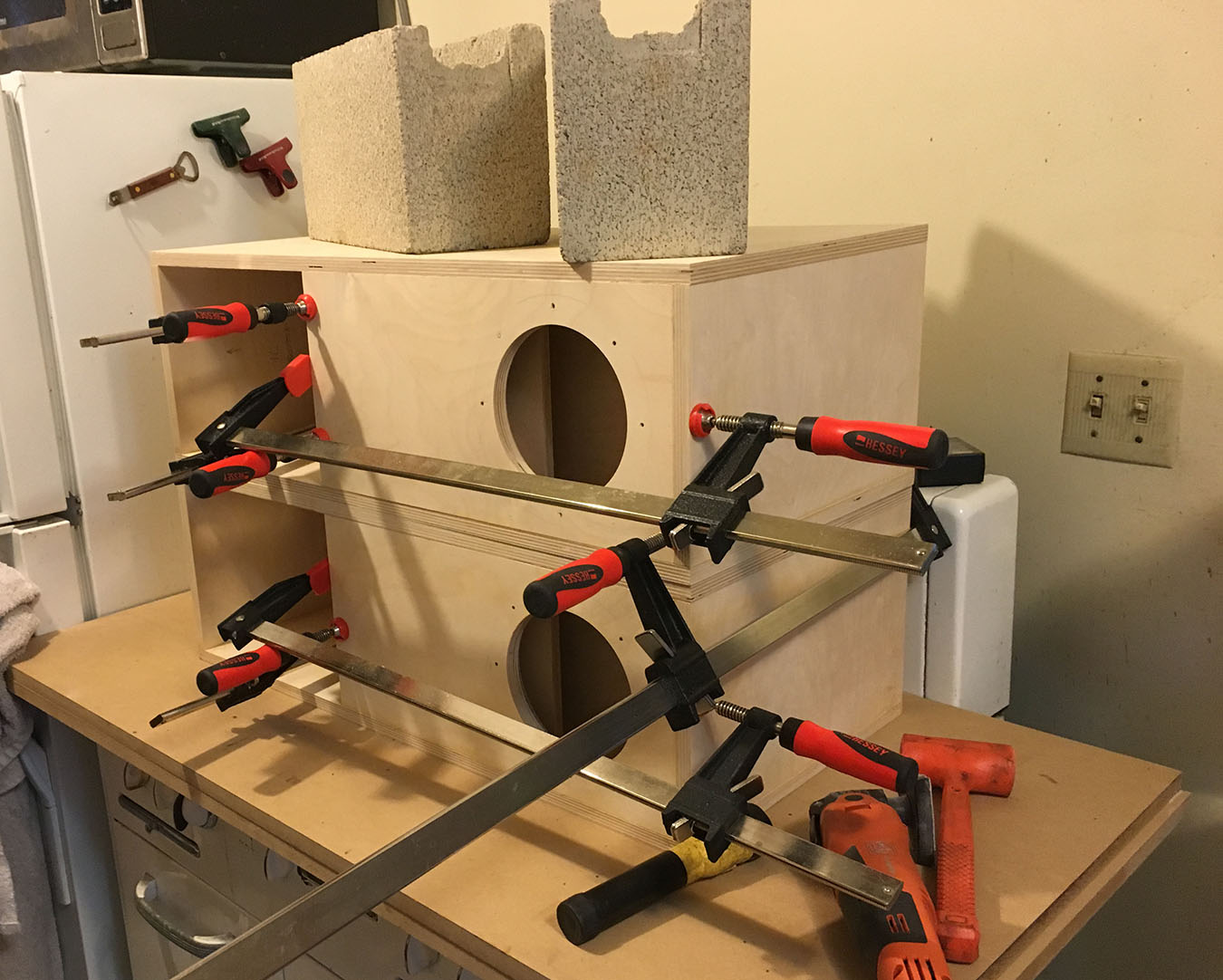

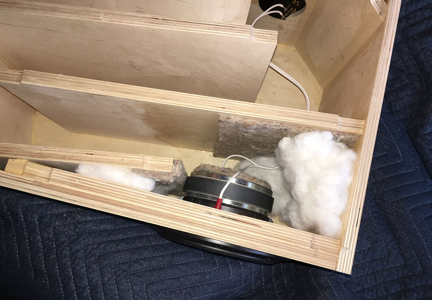

I completed the BK-16's and installed the broken-in Fostex FE168EZ's. Have been listening for several days and am quite happy. In order to tune, I have not glued the left sides- I drilled a series of countersunk holes for some brass square drive screws. Will be getting some neoprene 7 X 3mm tape to help seal while tuning.
I bought 2 pairs of 2' x 4' x 3/4" MDF boards from Home Depot ($14 ea), and checked them for flatness. To be sure everything stayed flat, I used 2 of the boards stacked as a assembly table. Because I couldn't go outside because of the rain, I used the stove top as a base. As you can see in one of the pictures, I used cinder blocks for compression on the vertical axis while gluing- and Bessey clamps for the horizontal axes. I like the cinder blocks because of the even pressure and quick. On final glueing of the left side, I will place the two other MDF boards on the left side with cinder blocks on top as well.
I wound up with about a 1/8" gap at the bottom of the compression chamber and figured it needed to be well sealed against the small triangular void below it- see picture. So I made wedge-blocks and glued them in (instructions called for use of "tag board"). The angle at the top of the blocks is 10.7 degrees.
I bought a 50lb bag of PlaySand at Home Depot ($4), and baked some in the oven because it was pretty moist. My daughter was pretty amused. Put as much as would fit in a heavy duty ZipLoc bag and stuffed it in the lower triangular void of the BK-16's. I fluffed out and installed some of the AcoustaStuff that came with the kit in some areras of the compression chamber.
Because I also noted the "reverby" nature of the BK's that others have referred to, I am installing 8" X 8" damping pads on the panel behind the drivers- and a circular pad on the back of the driver magnet. Also on the top and front corner of the angled panel at the bottom of the CC. For now, I am using some "24oz synthetic fiber pad" felt. This is used under carpets and is 1/4" thick- it's that stuff that's multicolored and made from new fabric remnants. I think I will be ordering some pure wool felt that is 1/2" thick for final install- not expensive- but comes from England. Is 1/2" too thick? Interfere with the throat of the compression chamber? I am using water based caulking to glue the pads in place- couldn't think of any other way- staple gun won't fit. Caulking should be pretty easy to remove while preparing for final pad install. Trying to get them to sound sharper, crisper.
These have definitely retired my previous favorite speakers (Bowers and Wilkins 805 Nautilus knock-offs). They are winning by a large margin. One of the things I like is that they don't seem directional like most speakers: I noticed very little difference in sound while sitting at a 70 degree angle off the firing line. Also, they sound more musical at low gain levels than any speakers I had. Both of these things are a big deal to me. These are just two details- I also just really like the sound. I think they somewhat favor instrumental recordings with space between the notes. That crazy song, "Barn Dance" by Moon Dog on that cathedral organ- wow. John Cage, Steve Reich. Tame Impala and Neko Case also sounded damn good.
I've never "tuned" speakers before- I'm shooting in the dark based on info in forums. I don't know if the approach I've used is best- just the best I could come up with- just wanted to get them up and running.
Thanks for help, Kip........

I'm waiting for some 100% wool 1/2" damping felt- also have 7mm 80/20 wool cotton blend. May try putting on front and back horn interior (not sides) except for final opening. One poster earlier in this thread I think claims to have success with that. Also, in info I got from Tang Band on their Nagaoka design, they recommend this in 7mm (1/4").
Currently am using small amount of "24oz synthetic fiber pad" (1/4") carpet underlay in compression chamber (see picture). Seems to be helping.
ChrisB: you were so right about the brass screws- I like the look of the brass- and I thought I might be leaving them in, so I tried them. Dumb idea- break too easy and complicated to pre drill. And I have decided I will not be using the screws in final assembly. But I will be assembling/disassembling many times trying to tune, so the brass is very impractical. First thought: drywall screws (square drive). Anyone have screw favorites or preferences?
