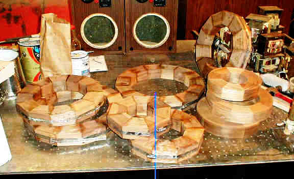

Great idea. You want a set of solid hardwood horns like the 450 Hz black walnut ones made for 8" drivers that I manufactured last week. I have an adaptor on them now to play with a 4" W4-656S Tang Band driver but am looking for a nice 8" to try as well. I was looking at the Fostex FF225K as a possibility.

Awesome horns! While I have access to most of the stuff one would want for building electronics I have nowhere to practice my woodworking skills so solid hardwood horns are unfortunately out of the question for now. Planning on building the horns out of plywood and/or the "Edgar" way.

rcavictim,
I just wanted to add that your round horns turned from walnut are truly beautiful. Just killer good looks and my sincere compliments.
I'll be very interested in the outcome, once their placed in the system with the 8s.
Question for you: Did you use a tractrix flare?
Also, you probably know this already, but mounting the TB on the horn my cause some irregularities in response from the mouth to throat ratio changing. Still, its fun to swap stuff in and out on the same horn.

Thank you and the other gentleman for your kind compliments on my walnut horns. They 'turned' out very pretty. ;)
I was limited in curve profile by the small size of the walnut scraps from a local mill that I used to make these. As a result the curve is only a 'by eye' best fit to a parabolic curve, not tractrix. The dress ridges in the horn are an attempt to leave meat where needed given a shortage of material at one glue joint. These are made from ring stacks of pie shaped chunks glued and faced on both sides first. See picture.
This is my very first attempt at gluing and turning a set of horns and I was more concerned with getting the technique down pat than the accuracy of the curve. Next time I'll possibly design a template to follow.
If I had a larger lathe I could make 22"-24" horns, which I'd prefer but 16" is the largest my Southbend will swing. I may make a jig so I can turn larger horns on the outside of the lathe headstock.
You are right about the 4" to 8" adaptor screwing up the taper rate at the throat end and I expected horrible things from this but initial testing sounds almost totally absent of the expected 'honk'. I'm certain that the right 8" FR driver will sound quite spectacular in these however. Unfortunately I have none to try. Donations humbly accepted! ;)
