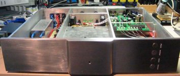

I finally finished my DAX-BOSOZ this week. It is a combination of Perpetual Technologies P1-A, P3-A with a X-BOSOZ output stage.
In the pic you can see the P1-A and P3-A on the right, the x-bosoz in the middle and the power supply for the P1/3-A on the left.
The power supply for the x-bosoz sits underneath the aluminium cover in the middle.

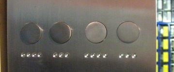

here a last pic of the front. On the right are the 4 pushbuttons and a row of 1mm holes for the fibre optics.
The front is 10mm aluminium, the sides and internals are 6mm and the bottom and top are 4mm aluminium.
With this one I now finally removed all opamps out of the signal path🙂
It sounds quite a lot better than the (modified) P1-A /P3-A combination. Changes are the same as when I changed from my OPA627 based preamp to a x-bosoz. It sound more natural throughout the range, somehow much faster, better (less thumpy) and deeper bass. Room information is also improved. This way listening to CD´s is slowly becoming acceptable😉

Here´s another pic of the little nobs. Drilling the 1mm holes wasn´t fun. I tried to drill through the complete 10mm faceplate but gave up after two drills broke (and got stuck). I then machined a 7mm deep slot in the back and put a piece of plexiglas in in to position the fibreoptics.
As always the mechanical part was a lot more work than the soldering🙄
